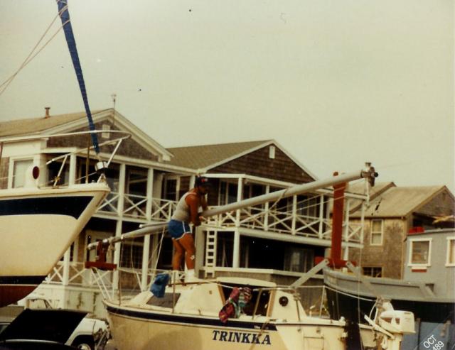

22 foot boats may be a little large for a couple hours out on the water in your situation, a 19 foot boat or smaller is more what you should be considering.
I’ve help raise and lower the mast on everyone of these pictured boats 19 to 28 feet many times.

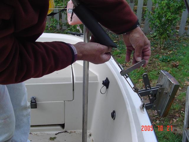

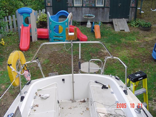

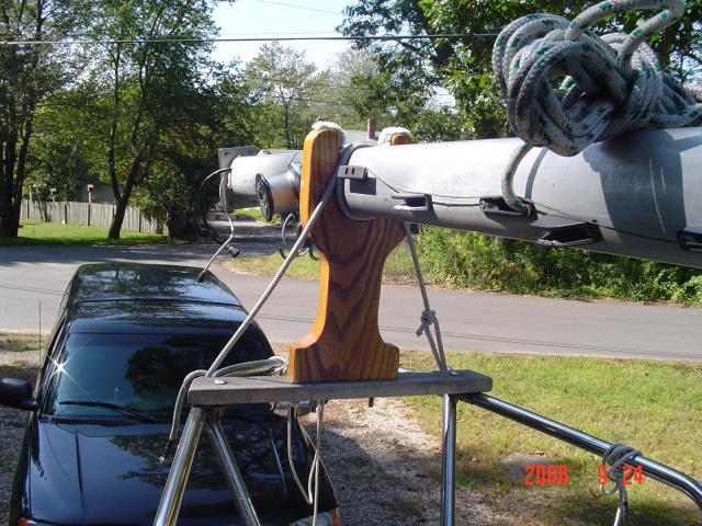

I trailered my O'Day 222 for about eight years back in the 80s and 90s about every week in the summer. I was younger back then and I wanted to sail my boat in different waters. I once overheard a cop sitting in his cruiser at the ramp say to another guy, "he goes through all that work just to go sailing" and he was shaking his head while he was talking to the guy. I really didn't give a darn what he thought because I had a regular routine of mast raising/lowering that became so easy after a while that it became second nature to me, but there are a lot of variables in mast raising, and one of them is age. Being a "Geezer", I couldn't go back to doing that again. The other variable is keeping the mast raising/lowering as simple as possible and by that I mean, having no furler to contend with and using no Gin Poles. If you have a furler, you need a Gin Pole plus baby stays, which takes up a lot of time to set up and break down. Outside of that, all you need is a mast crutch with a roller on it attached to your stern pulpit, and a single sheave for the bow plate for a 60' 3/8" line. My line had an eye splice in which I could hook my jib halyard to and raise the halyard to the top and cleat it off at the mast. This line only served to hold the mast in place after I bulled it up while standing on the closed companionway hatch. When the mast was up, I'd take a turn around the mast --above the goose neck-- and tie the line off to the Starboard bow cleat. Then I could take my time and connect the fore stay. A Johnson Handy-Lock on my back stay enabled me to loosen or tighten everything up without having to touch any turnbuckles on my boat. The Handy-Lock did it all. So if you're young, and you can keep it simple, it might work for you. Once you develop a routine and stick with it, it become "Ole' Hat."
