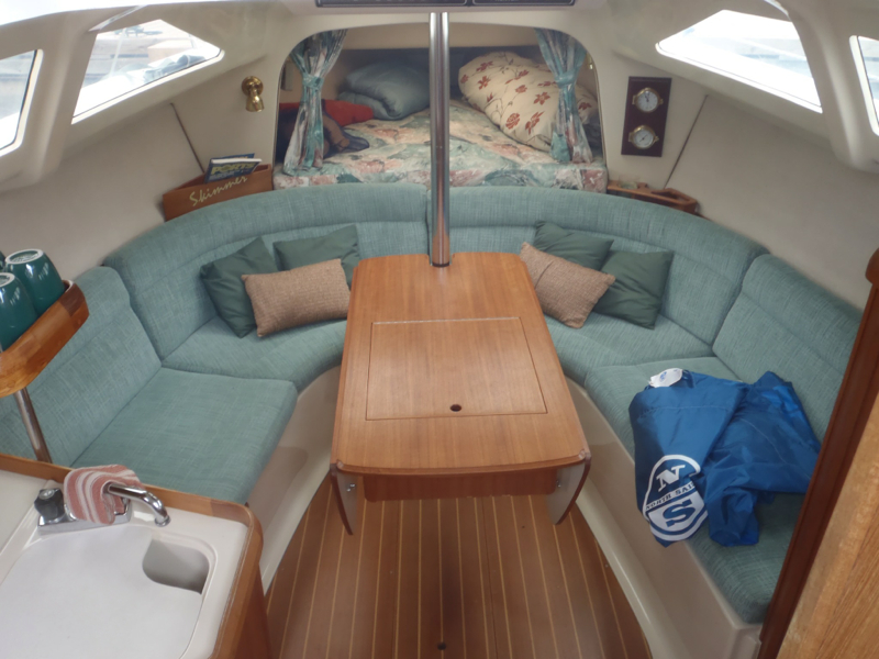

I was wondering if you would know the length of your v-berth in the 29.5. I am looking at purchasing 2 9 or a 29.5 and this would help.

I'm not sure of the exact dimensions of the v Bert, however when I crawled in there it seemed adequate for an average sized couple. Certainly no smaller than the v berth on our Aquarius 23, which was 6' The aft berth however is huge. It is like a long queen size. The table also lowers and will make up into a large double bed.
The interior size and layout was one of the main reasons we chose the 29.5. Also the large windows above the v berth give a open feeling to the cabin. I'll try to attach a couple photos from the survey.
