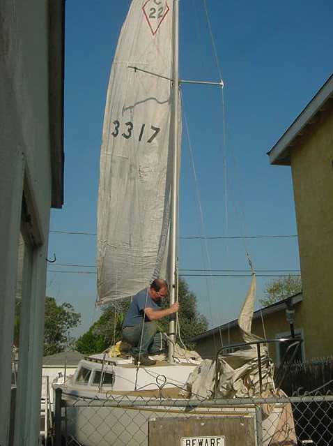

WHAT I WOUND UP DOING WAS
to attach my winch from the trailer to the forestay, and attach the aft and main stays, then while i lifted the mast part way up, my neighbor cranked on the winch and cranked it, the mast,all the way up while i steadied it from moving side to side, which was very very little,,keep in mind i used a very heavy blanket on the bow so as not to scratch the boat with the winch cable. this worked great!!! i now know that i need to replace some rigging and some halyards before i take the boat anywhere for my first sail..i plan on doing this a few times so i can get it down pat. also i used a long mast support on the stern to aid in mounting the mast in the step, ie keeping the top end up high while guiding it in...as time goes by, i'll be trying some of the ideas given, but for the first time.. this worked out great.... thanx all...dont know how to add a photo,, but will send one of the risen mast if requested,,,
