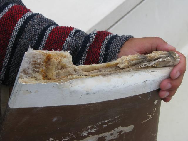

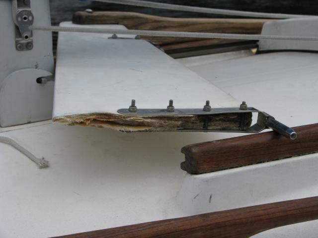

This is a great discussion, and it reminds us all to be better sailors for those times when things go wrong. And as we all know, when things go wrong, they go really wrong! A couple of years ago, my boyfriend and I were sailing on our 22' O'Day sloop during a good blow. Bob was on the helm, and I calmly heard him say "We've lost our steering." What?? Looking behind us, I saw half of our fractured rudder floating on the surface 50' away. It was blowing a good 20-25kts, and we were quickly approaching the rocky leeward shore that we'd tacked away from just minutes before. We quickly began to strike the sails and start the engine... and of course this was the one time that our trusty 9.9 outboard did NOT start. At this point I became a bit frantic. Had I taken the time to think about things more calmly, I would not have gone to strike the sails so soon and put all of our faith in the engine as a "get out of jail free" card. Bob and I knew the physics of steering by sail alone, and had even practiced it a little bit, but the engine gave us a false sense of security and let us be lazy sailors. By the time that Bob got the engine started, I was thoroughly agitated with myself for being so hasty. Once we got our rudder repaired, (rudder 2.0 is far superior to the original) we ditched our 9.9 engine and decided that we were going to learn to rely only upon our sailing skills. This connection to problem solving relying solely upon skill is not only more rewarding, but far safer. We have not missed the engine at all since we got rid of it. While it's true that we have to be more flexible with scheduling, our sailing skills have evolved and we all know that sailing and tight schedules mix like oil and water. No more sense of false security, and docking under sail, heaving-to and practicing steering with the sails has greatly enhanced our confidence in ourselves and each other. While I agree that most people aren't going to go out and ditch the engine, maybe we can start to "Sail like you don't have an engine, Love like you've never been hurt, and Dance like no one is watching" :)
erin & bob aboard the sloop "Emerald"
www.rib-bone.com
Some pictures of our severed rudder here:
http://www.rib-bone.com/Rib-Bone/Photos/Pages/Reconstruction.html#16
