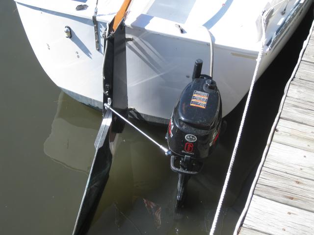

I've also see some add a simple post on top of the motor case to use for steering (but no motor controls).

I like the way the Hunters have a bar that connects the tiller to the motor. It sure would make turning easier. I have to back out of my slip and avoid other boats - it always makes me nervous. I use all of the above navigation techniques in no particular order :doh:

I have a Hunter 22 and I installed a connecting rod between the the tiller and the outboard motor. I got the rod from West Marine and it took a couple of attempts but works great. The connecting rod has a quick release and you need to disconnect it before raising the motor.

I hope to build a linkage between the tiller and motor at some point but have not done it yet.
