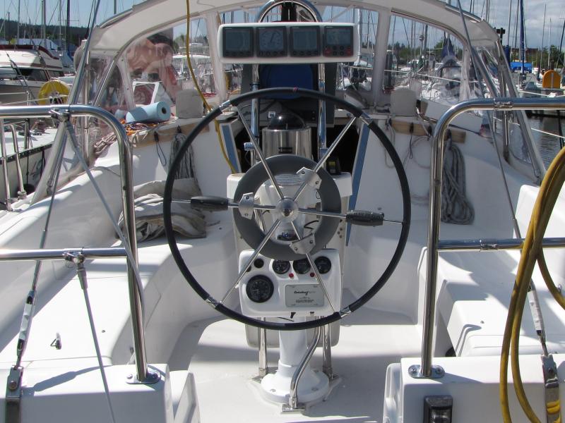

Recently made the decision to purchase a folding wheel. Made the purchases recommended by DJ. Got to the boat this weekend and attempted the installation. The mock up went beautifully. The actual installation had a few issues I am still trying to resolve.

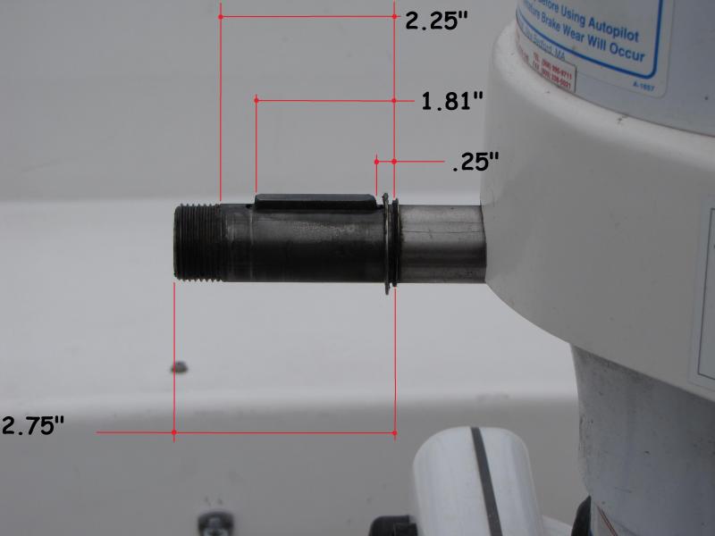

First, my boat (2005, hull 299) is equipped with a tapered shaft. So, I will be returning the shaft coupler. Second, it appears that the folding wheel is offset approximately 1/4" forward then the original wheel. Not a problem unless autopilot is installed. So I will need to purchase a new raymarine pedestal mount to extend far enough to hold the wheel mount stationary. Then, there is the issue of aligning the spokes to align and secure the wheel mount.
Any thoughts, advice or ideas on how to address these issues in much appreciated.
