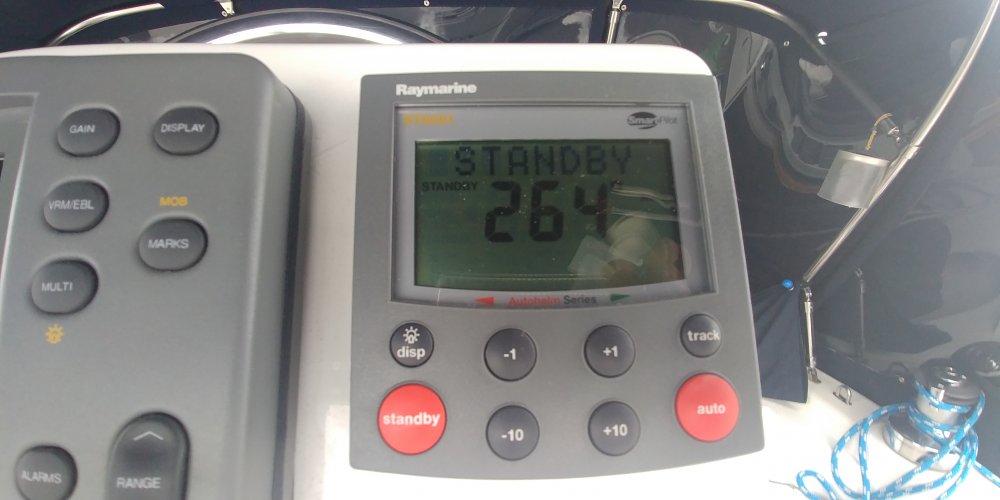

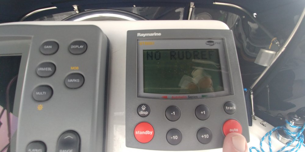

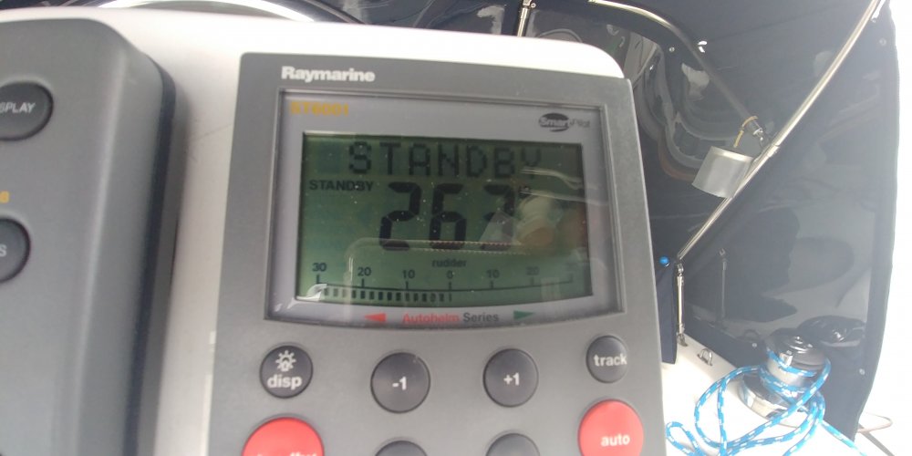

Your responses are right on track with what I was thinking. It definately jumped some teeth. But at the drive or at the helm? Im thinking maybe both because of the RPS (rudder position sensor) confusion When I inspected it at the drive,the chain and bolts that hold the drive in place were loose on one side. The chain was actually clanking inside the pedestal shaft when healed in seas. Fixed! Now to recenter the wheel. Sounds easy enough. Remove compass and expose. Chain off sprocket and center. So the sensitive part. I know of no damage to rudder and inspected RPS on last visit and all is well there. The sensor works because it works when auto is selected. So your saying get the wheel centered... make sure rudder is centered and then reboot. I forgot I had a few pictures of RPS symptoms at the control head. All wiring at S3 panel is connected.
