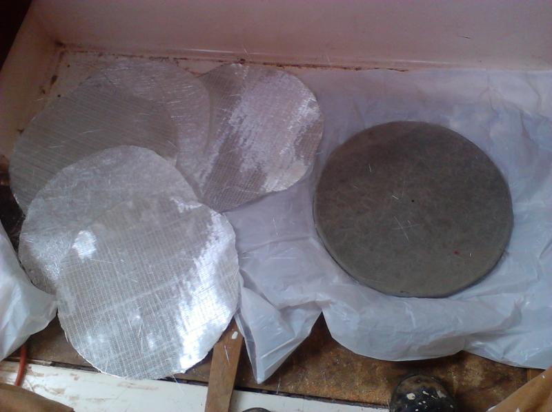

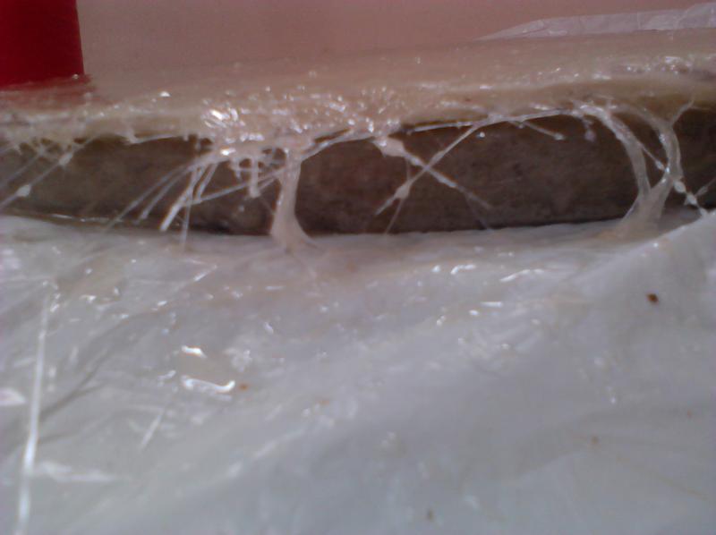

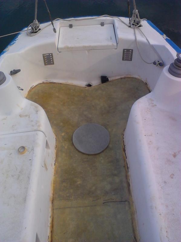

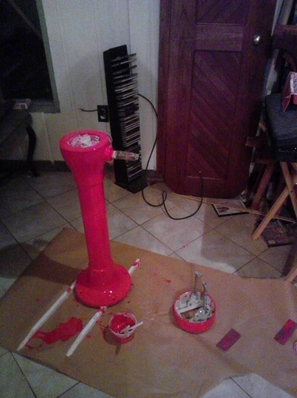

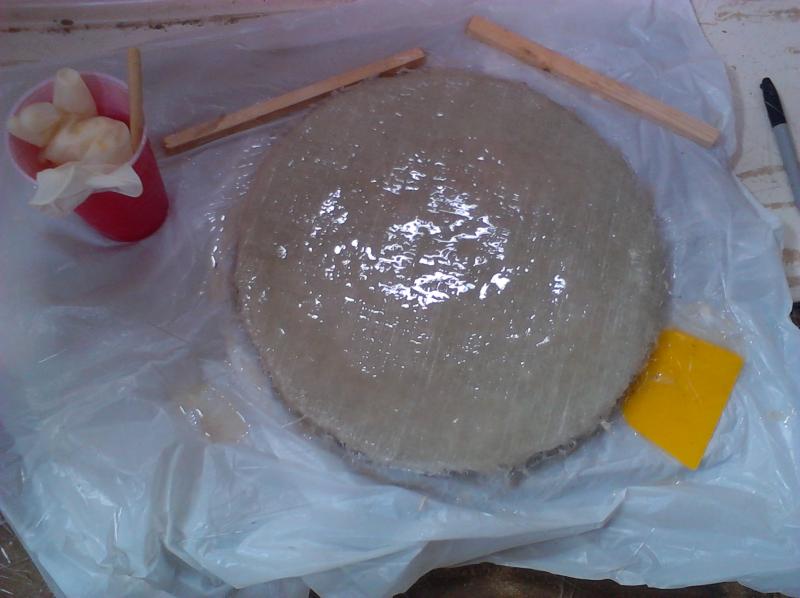

I have just finished glassing in a new cockpit sole, the old diesel fill and pedestal mount allowed the entire core to rot to hell. So the diesel fill will be moved to a better spot and the pedestal will be raised about 3/4" (slightly more after the glass layup) The pad is the same as the core, "coosa" a fiberglass reinforced foam, and oversized 1" all around the pedestal base. I am taking tomm. off work and glassing this pad down and fairing the surrounding layup. However I can't remember exactly where the pedestal was mounted. Obviously centered athwartship but can't remember how far fore/aft. If you have any pictures or thought on the matter please chime in.
