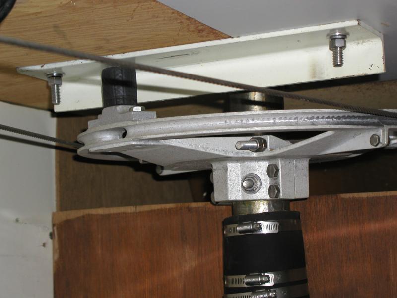

Steering on 31
Other thing to check is that there should be no wetness getting there to cause the corrosion. The cleanup and Boeshield is in order.. but do find and stop the source of water.. Pictures are of my '84 model .. no cleanup since new.. is lightly lubed and wiped down on 24 month intervals
