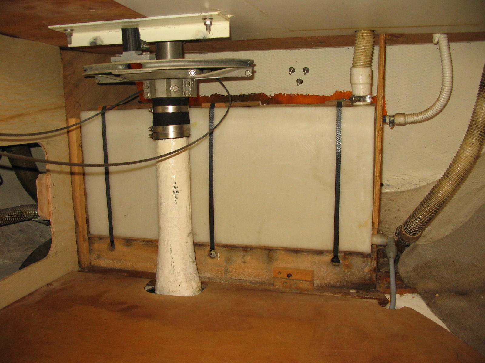

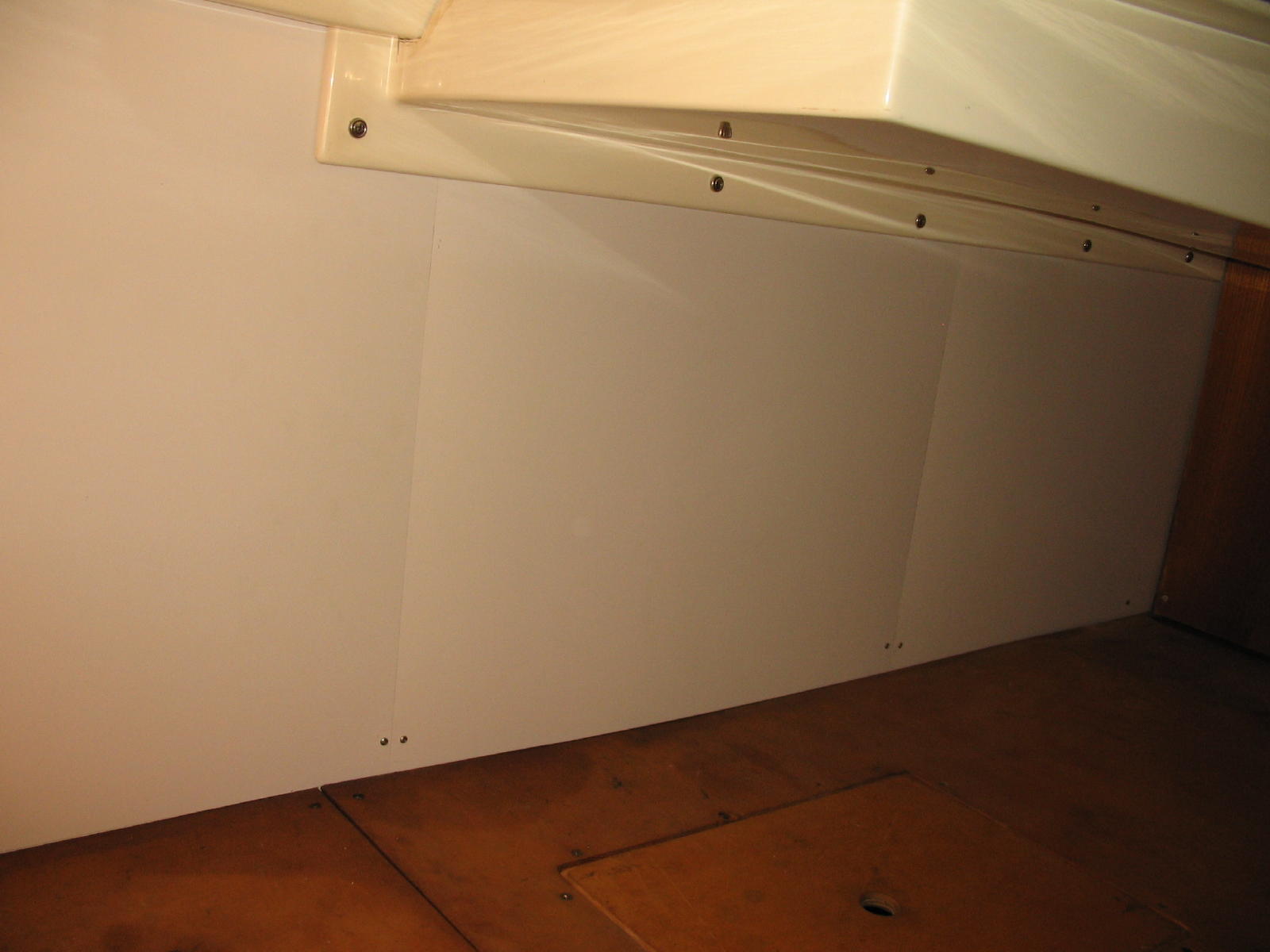

- On the 34, you can go in the stern cabin and remove the cover of the steering cables and quadrant (See pict). You could run the boat visually inspecting and checking before going out in the morning, then go see if anything has changed when the steering gets tough to turn. (Would help to have someone at the helm while you do that).
- The 2nd area I can think of would be inside the pedestal. With a good flashlight if you remove the compass you might be able to see if anything is wrong in there. You can also look upwards from the stern cabin through the holes where the cables run (of course with the cover removed).
- 3rd and lastly, is the steering difficult with the slightest movement to port or starboard, or does it seem to get pinched with a greater angle of turn, meaning you need to turn the wheel more. Measure the number of turns from dead center going left and going right. Then when it gets difficult, measure about where does it start ? Sometimes the top of the rudder might rub against the hull, creating friction.

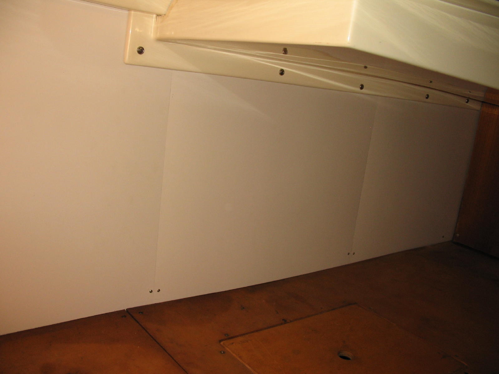

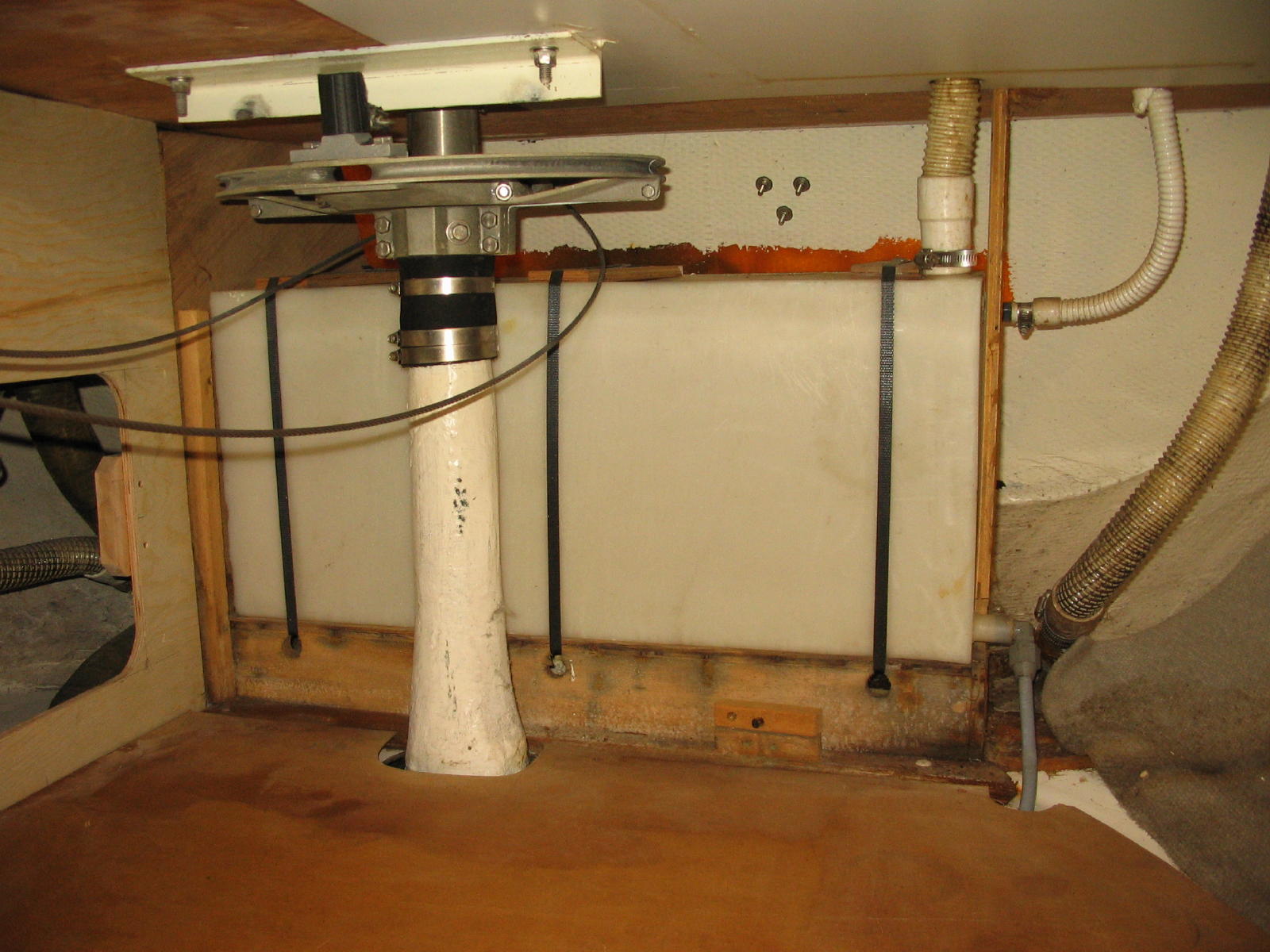

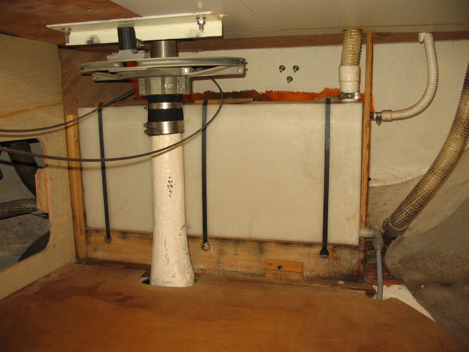

Jim, thanks for the update. Now FYI, I have a 34 Serial # HUN34724G484. If you look on the upper starboard side of the transom you should see your boat serial # and that will tell you exactly what boat you have. Hunter made the 34 from 83 to 87. It's LOA is 34' 5'' not 33' 6'' like yours. Hunter made a model 33.5 from 88 to 94, so you may have that model. Again FYI I have included a picture of the steering apparatus and also one of the cover I was talking about in the 34. I don't know if any other model has that. You say when you disconnect the steeting cables the wheel turns freely. On the 34 in order to disconnect the steering cables you have to remove the cover from the top of the stern cabin. Not that it helps your problem but it might help to get more folks offering suggestions if you are able to properly identify which boat you have. And I believe Markwbird made a typo and said bait instead of boat, so he was basically asking the same question I am. Good luck.
