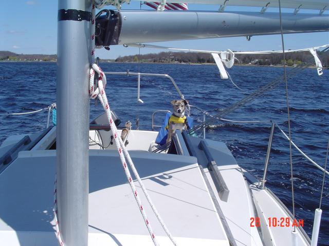

A lot of guys on this forum have asked about single handing and they have often equated it with running the halyards back to the cockpit. My only answer to them is; Single handing =an autopilot. Leave the halyards right where they are. My boat is only 22' long, but I wouldn't sail it anywhere without my Autohelm ST 1000+. The autopilot has freed me up to do a lot of things while under sail that I couldn't normally do, but you still need to watch where you're going at all times. Large masses of metal structure nearby can cause the pilot to steer off in the wrong direction. For instance, the new drawbridge that is being constructed on the river in my area has caused my autopilot to steer in the wrong direction. A portable radio set down near it will cause it to deviate. So, the autopilot, and a roller furler is about all I need. You can also have a lot of fun with an autopilot. Sometimes I stick Penelope out in the cockpit by herself at the helm and hide in the cabin just before a powerboat goes cruising by. I can hear them say, "Hey look, that dog is steering that sailboat!!!" Meanwhile, I'm hiding down below looking at them through my port light going,-- "Hee hee hee!" :D
