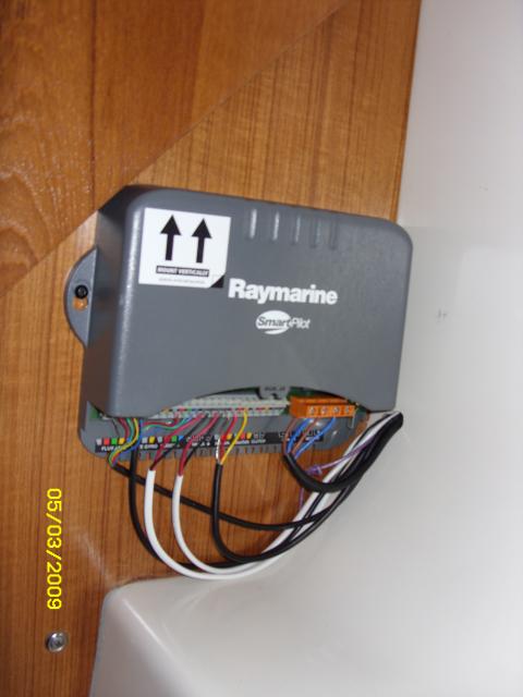

My AP is a Raymarine Smartpilotx-5, which does not need a rudder sensor. I was going to follow your examle of locating the computer below the chart table, but was a bit nrervous about messing things up and therefore hid it in the port shelf of the rear cabin against the rear bulkhead. The fluxgate is mounted under the sink facing aft.

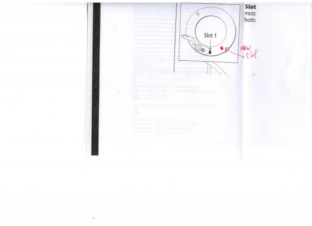

The slot I meant is the one in the rim where the motor sits, into which the grey bracket fits – as per copy of manual excerpt attached. Unfortunately, I could not take a picture as it is raining here and too uncomfortable to dinghy over to the boat.
I thought that if I cut another/new slot, as per the drawing, I may be able to save moving the control box (which seems in same place as yours, below the wheel).

Ahhh, Those slots
Albanach, I had forgotten about the slots on the back of the wheel. To be honest I don't know if there is really any way around that. I suspect it is also a little bit of the luck of the draw as to where the engine control box sits. But, it was not a big deal to move the box as I learned from reading Paul or Witz's experience and then doing it myself. The box is not all that delicate and really just a matter of deciding what to do. At one point I was thinking of putting the clutch lever on the port side as I am left handed, but then decided it just made sense to stick with a stbd side installation. You will find once you pop the box open there is a lot of room and it is not that big of a deal.

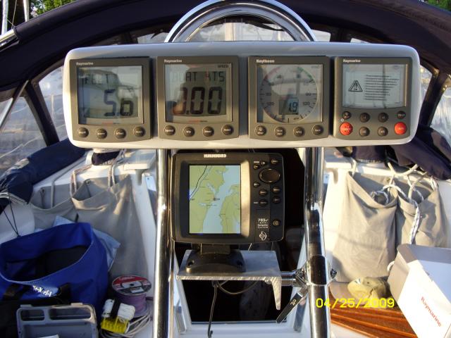

I have the 4 instruments in the NavPod
I had room for one more instrument in my NavPod so I added the control head there. Really is the best place for it. It is only about 12" away from the compass, but I have noticed no problems. I have also attached a picture for where I mounted the computer. This made it easy to add it to the power panel (I had a spare breaker) and use the factory cables.
If you need to add another Navpod below for the control head, it would seem to be easier and cost about the same to replace your existing Navpod with a larger one. What do you have in your existing Navpod?

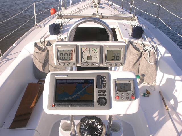

My setup: As you can see at the time the picture was taken the compass and auto pilot is 180 out because it is mounted facing aft. The commissioning procedure for adjusting the heading has provisions for correcting this.
When I executed the truns to calibrate the fluxgate, when it was mounted under the sink I received a number of 13 for the deviation reading, outside the acceptable limit. After relocating the fluxgate to the aft berth shelf wall, I received a 3 for the deviation. I beleive the perminate magnets in the shower/refrig. drain pump and water presure pump was causing the problem.

Use a Dremel tool and grind the clutch handle to fit in the existing location or you can add a spacer on the steering wheel shaft behind the hub.
Grinding the handle was a better solution for me.

Ok, thanks, guys – I am convinced and shall re-locate my FG compass to the aft port berth shelf and the Course Computer below the chart table.
As a matter of interest, Witzend and paulj, where did you place your Course Computer? Chart table location seems to make it essential, as per rpwillia, to route motor cable thru dropped engine instrument housing to obtain necessary length. I may have a slight problem here as from memory the cable pipe does not lead entirely vertically into the housing.

Mine course computer is located where RP's is.
To get access for running cables take out the small wooden cubbie under the stove then when you drill the holes you can reach in and fish the cables through.
