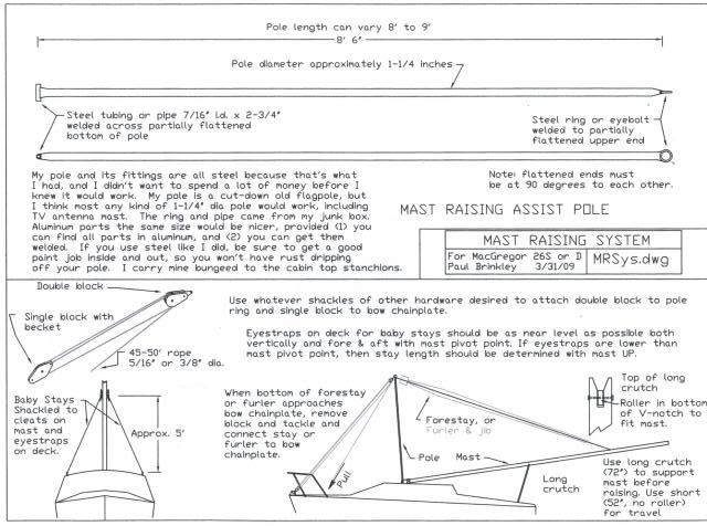

I too am new to owning my own sailboat... I have a friend who taught me how to step my mast with only 1 or 2 people.... I made a gin pole with eyelets on top in opposite directions (forward, reverse) facing... then drilled a hole crossways (port to starboard) at the bottom... I attached 2 flanges to the deck in front of the mast step to fasten the pole into.... I then fasten the jib halyard to the pole, and block and tackle to the pole, then to the forestay chain plate on the bow... then I hoist it up....
here is a diagram used by Mac owners for their boats...

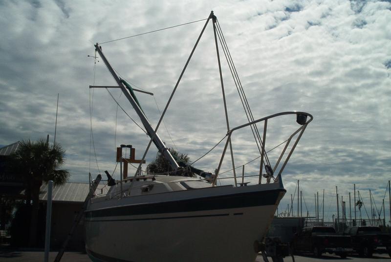

Here's my system-
http://forums.oday.sailboatowners.com/album.php?albumid=1052
I used the jib halyard (the main halyard will also work. Even the fore stay or the jib furler but you'll need some one at the mast to hold it up. It doesn't take much to hold it steady when it's up) hooked to the end of the a-frame. It works pretty well, up or down, especially with one or two extra hands. You'll need some kind of a crutch to catch it after it comes down (I assume you're taking it down). Just go slow, think it through and watch for anything catching or straining. The mast weighs about 60#. Let us know if you need more info.

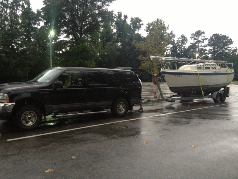

Trailered my (New to me) Boat over the weekend from Kerr Lake Henderson NC to East Orange NJ and after a few hours sleep on to the Marina in Parlin/Sayerville NJ
