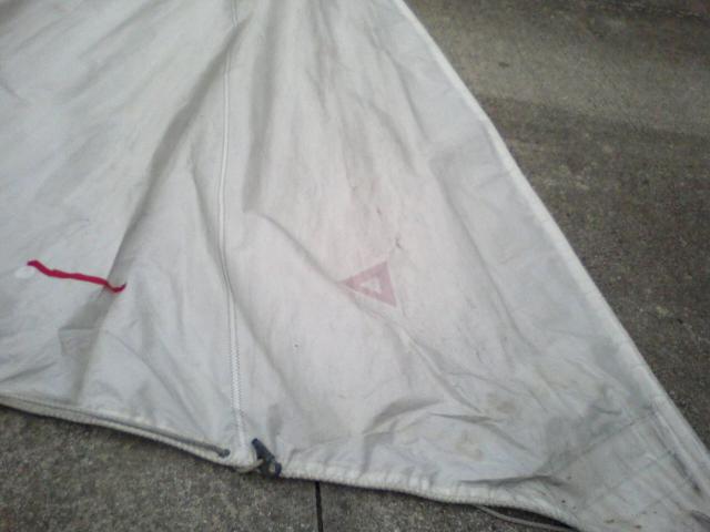

I was collecting my sails for their summer overhaul at North St Pete this morning. Took the cover off the staysail, stripped it off the boom and laid it out to flake. Found 3 hanks on a piece of 3 strand line. I have seen this on Mains to allow reefing, but I am puzzled why a staysail with no reef cringles would be rigged this way.

Mine is exactly the same Bill, original. Never gave it a lot of thought since it flies just fine. Could it be to aid flaking? The sail has such an odd shape that if the hanks were on the luff rope maybe it wouldn't fold. Its hard enough as it is.

I found that for certain points along the sail the distance from the rear end of the boom to the inner stay is greater than the length of the sail as it is being raised, so if you don't have that piece of line it can't be raised.
I found this out the hard way by removing the line because I did not like the way the sail luff tended to not be straight. Now my sail shape is better but I have to slacken the outhaul to raise and lower the sail. Once raised the outhaul can be tightened.

Got to have a line on first 3 hanks
John is exactly right - the geometry of the staysail is such that you would not be able to raise it without the luff downhaul line on the first 3 hanks (or you could slack the outhaul, as he does). I guess one way out of the conundrum would be to install a furler and do away with the boom, but I'm cheap so I stick with the original design. I did install a reef on my staysail - and never used it - I figure it would be quite a gale before I put it in.
