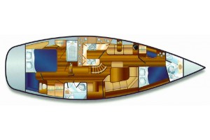

That's in and above the ceiling in the forward head? My guess is that you'll need to tie it into the hull with something that spans to the hull.
I'd seen turnbuckle and cable arrangements (we have one for the removable storm jib stay (that I never use) on our J-Boat. It takes the load and transfers down to the structure below.
You said the mast is designed to receive the rig? Doesn't your boat have an in the mast furler and the Hunter's "complex" rig?
I'm surprised that is so without a provision at the "deck" and something I've not seen on any picture of a Hunter 456. How are you going to deal with the attachment and the transfer of forces to the mast and aft to the deck?
24,509
If the boat layout is similar to the design shown in @SG ‘s message I looks like you could tie in a “Chainplate” to the Bulkhead at the anchor locker. Perhaps you can configure a “L” shaped plate that ties into the bulkhead and serves as the backing plate for the on deck padeye you have indicated. This way the bulkhead transfers the forces of the staysail across the whole of the deck and to the hull (assuming the bulkhead is adequately tabbed to the hull).
It is an idea. Not sure of the material engineering, but it is a start at a way to properly secure the staysail to the boat.
