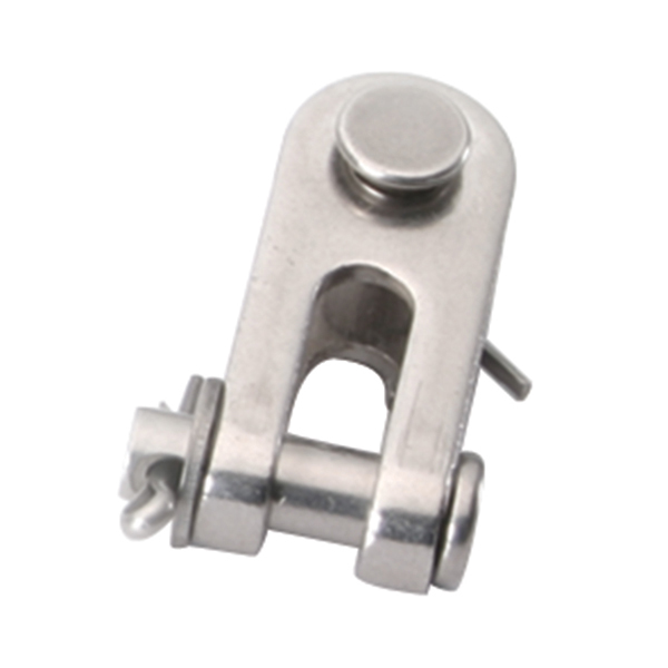

Or the hull is too flexible? I'm not sure I understand why they had to pick up the boat. Why not just loosen the toggles? The toggles had to be loosened anyway to remove the shrouds, no? Are they at the extreme end of the range?

All boats change shape when on the hard, some more than others. With that said, the stays should always be long enough to be attached in spite of the boat's shape. If they can't be attached, then they are too short or the hull has flexed too much. If the shrouds are too short, that's an easy fix, add a toggle or get longer shrouds. If the hull is flexing so much the shrouds don't fit, something is wrong with the hull.

Yeah, the distance was about 8”, a bit too far and unreasonable to add hardware that long. What I wonder is what happens if a boat with the same problem is stored for the season with the mast up? Must be a great deal of stress on the rig, so much so that damage could happen.
