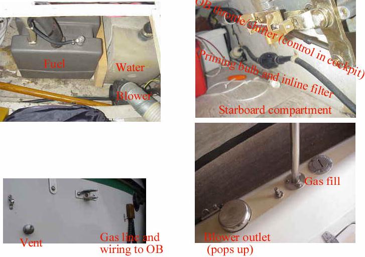

I have installed a tempo 12 gal internal tank in my 25. Love the convience, but there is a problem. After starting, it runs 1-3 minutes, begins to stall and if I squeeze the prime bulb 4-5 times, it recovers. No squeeze, it dies. This goes on interminttently. Also, if I run the engine at low RPM, most of the time it is OK.Fuel line progression is as follows: tank, anti-siphon, valve, prime bulb, auto gas filter, thru hull and 9.9 Johnson. It is 5/16 line about 7' long including all the fittings and the engine is about 1' higher than the tank. Ideas? Here's some of mine:Anti siphon is a problem.Filter is a problem.Install 3/8 line and equipment.Engine fuel pump is a problem.I had the engine tuned this winter, with the portable tank, and they said nothing. Maybe I should call them too.Riccomes a timeAmherst, NH
