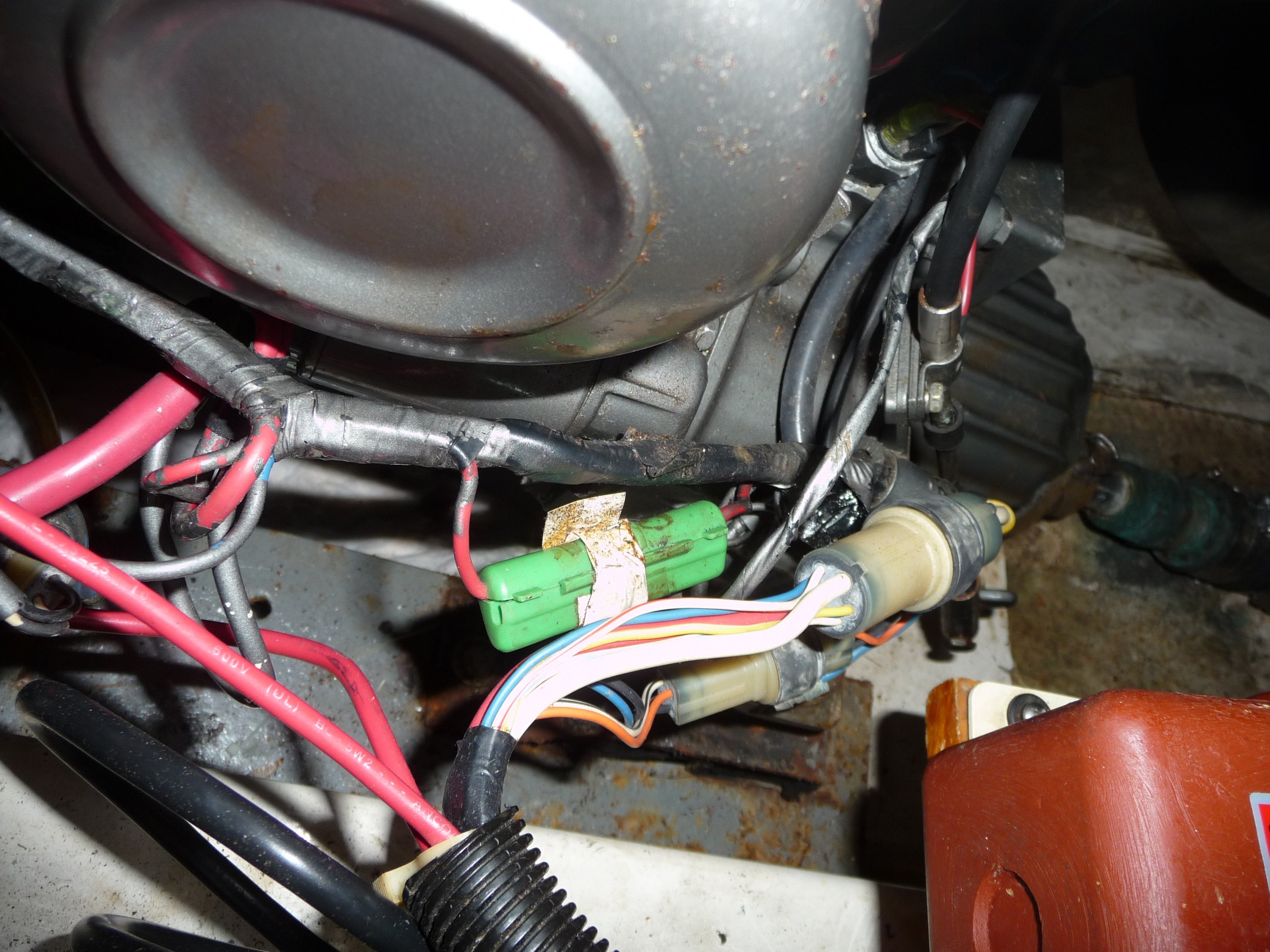

Does anyone know where a "fuse block" or inline fuse would be hidden that, if blown, prevents power from the batteries from getting to the key switch. The only way I can crank the diesel is using a temporary wire from the "battery" post on the key switch to a positive battery post. I have the original manual which shows a wiring diagram but cannot locate the "fuse block." On my Oday 26, normally the key is turned "on" and the starter button is pushed to crank the diesel.

There is a little green plastic fuse box that holds a 30 amp fuse in a red wire that runs from starter to the key switch. The box is usually around the rear of the engine on the port side.. On my 3gmf it looks like the attached picture.. yours will look about the same.. It is a badly made little holder .. the fuse or the wire may have loosened.. P1030597.JPG
3,030
Catalina 320 Dana Point
The crappy inline fuse Kloudie mentions seems almost universal among builders, I've also located them on top of the engine and they are usually encased in copious amounts of black electrical tape such that you don't know it's there until you dig through the damn tape.
FWIW when the fuse gets loose while the engine is running, it keeps running.
