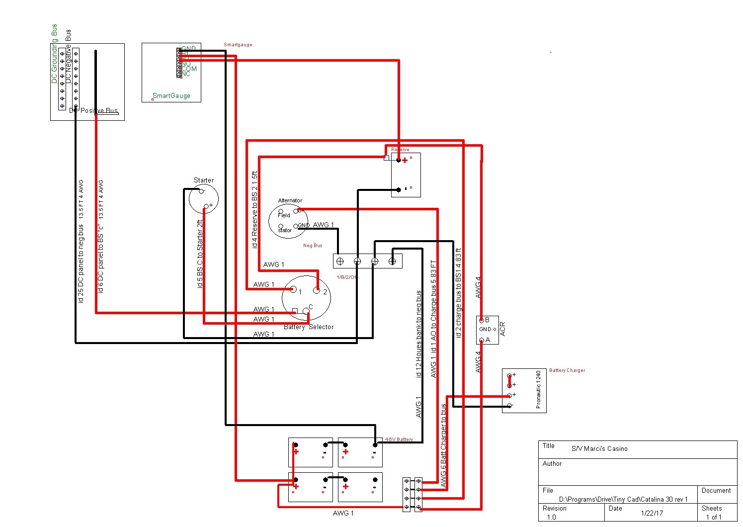

I've decided that now is the time to tackle the DC part of my Catalina 30. I think I've got it worked out, would just like a little bit of a warm fuzzy that I'm headed in the right direction here before I head off and spend some money.
I've attached what I think I'm planning on doing as far as a wiring diagram.
I do have some questions/reassurance that I'd like help with.

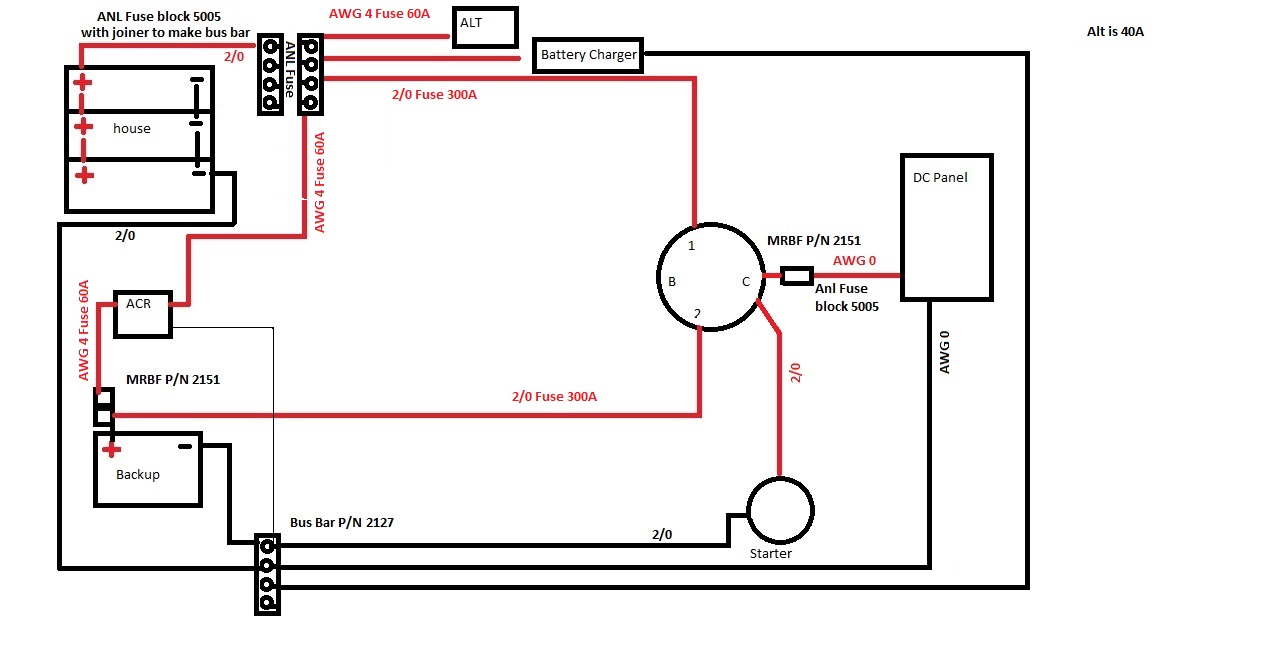

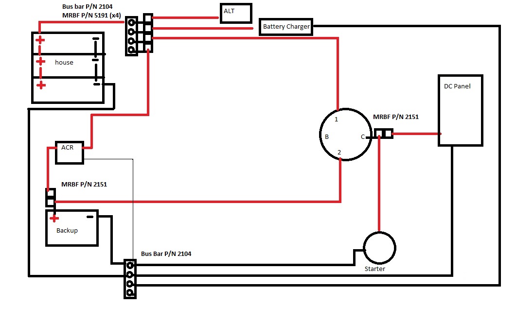

For the two bus bars I've chosen blue seas part number 2104, which is the heavy duty 600A bus bar for the positive and negative bus. I believe this is the correct one based one the others being rated at 250A.
As far as fusing the wires, I was planning on adding the MRBF to the bus bar and fuse it appropriate based on the wire size. Is there a cleaner/better way to fuse the loads from the bus bar?
2/0 seems to be the appropriate size for all the battery cables and battery cables to the backup and the house bank to the Battery switch, and then to the starter. This would include the negative cables as well correct?
And lastly the Positive and negative run from the battery selector to the DC panel gonna be about a little less than 30ft round trip back to the negative bus, (Nav station to the forward seat in the dinette.) I suspect I also want this to be a low voltage drop as well which would require some rather large long run of wire correct? Using the blue sea circuit wizard, It looks like i could use 0 AWG for a 3% VD or would it be better served with a 2/0 for a 2% or is that just going over kill on these large wires going all over. (another side benefit would be it would be fused already if i do not change the sizes)
