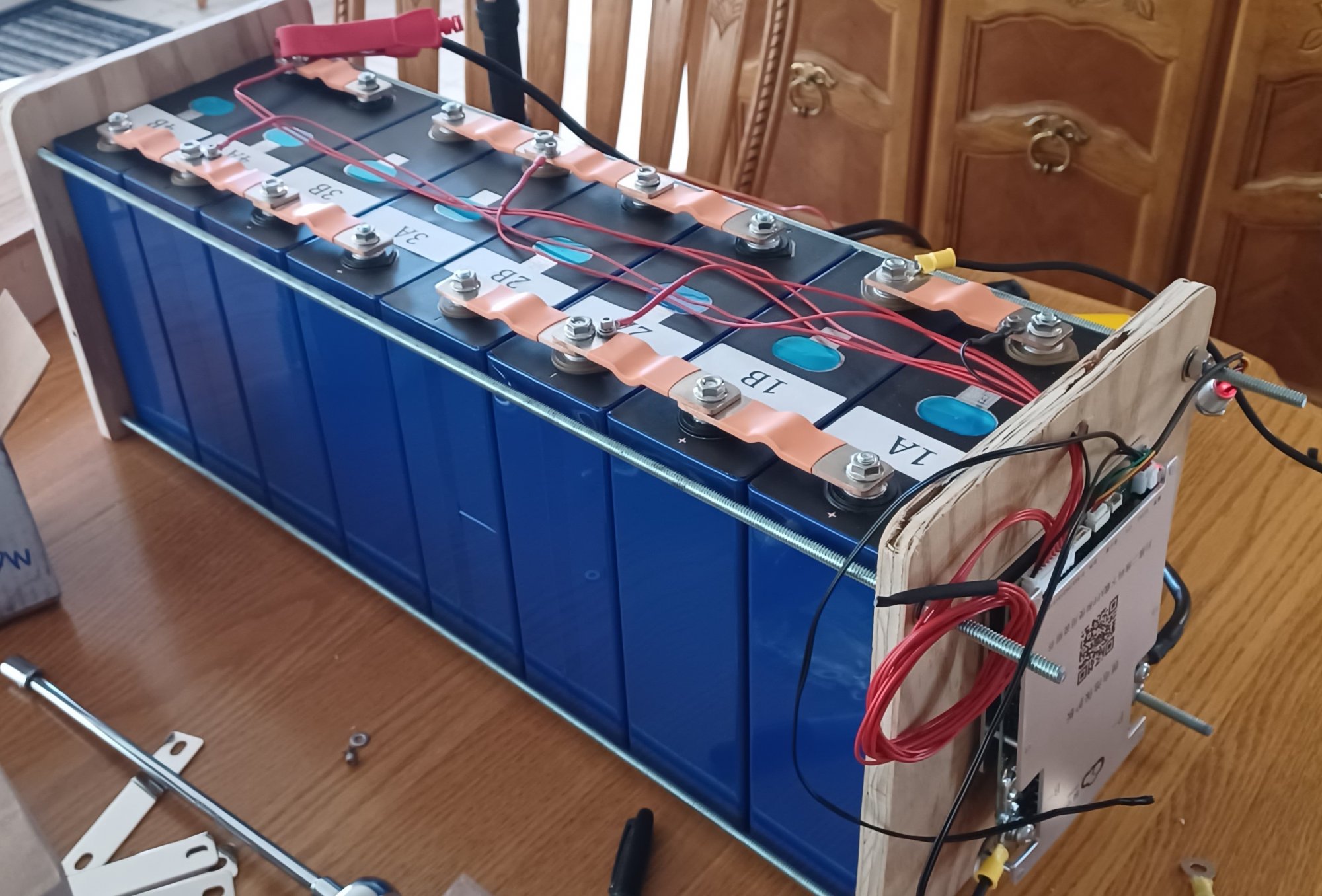

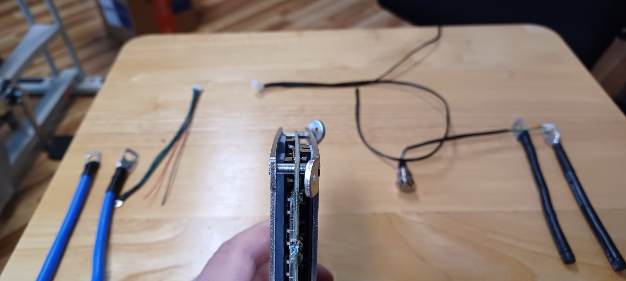

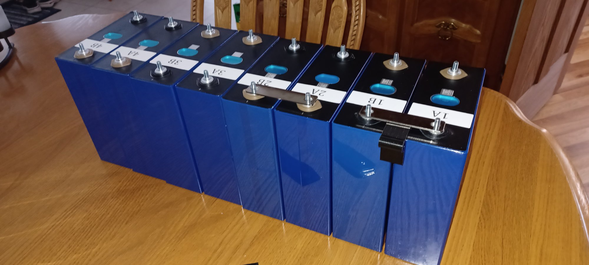

Well i finally did it. My LFP build is underway.
Now I just need to wait for the slow boat from China!

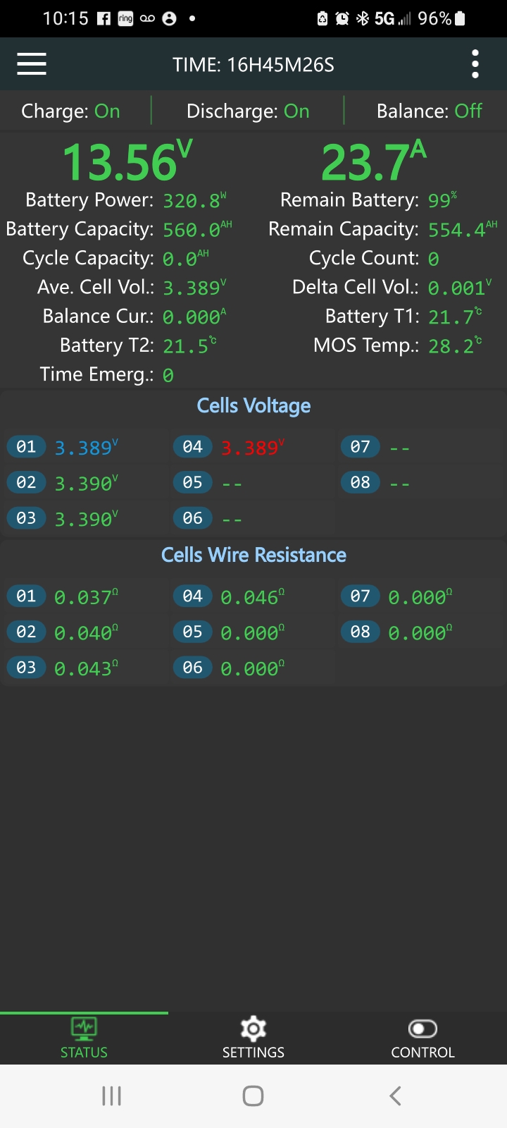

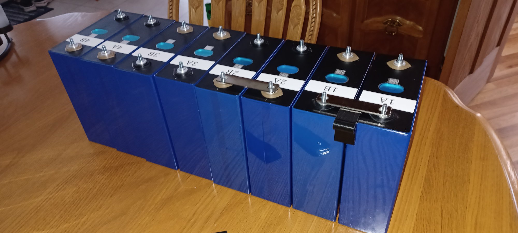

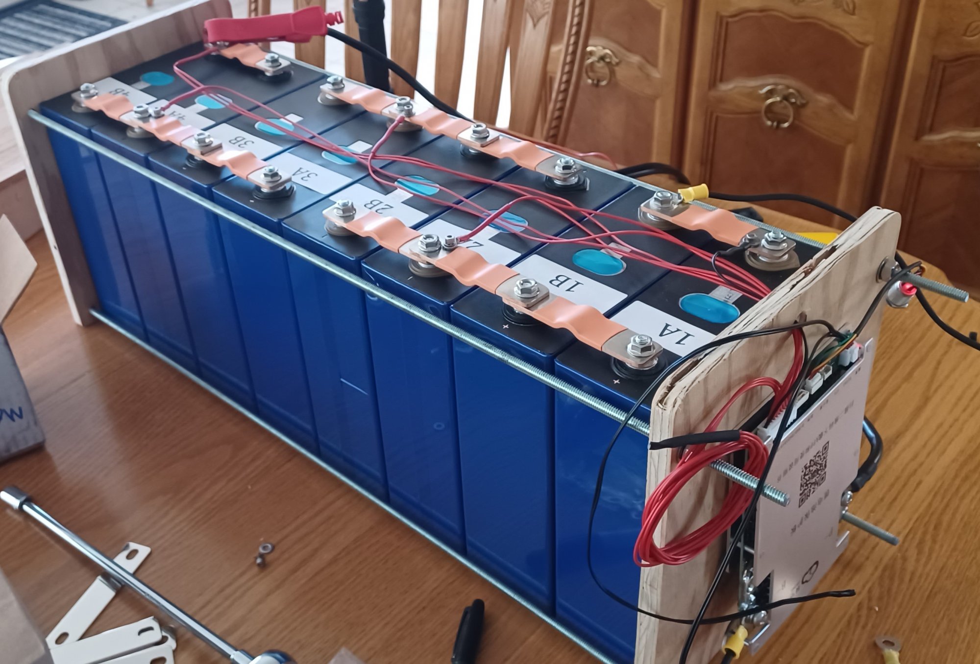

- (8) EVE 280K (560A @ 12v)

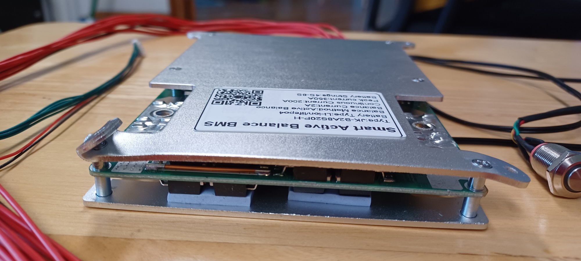

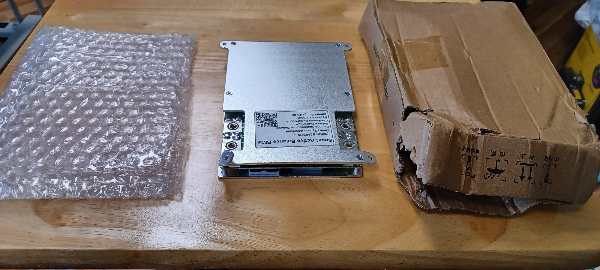

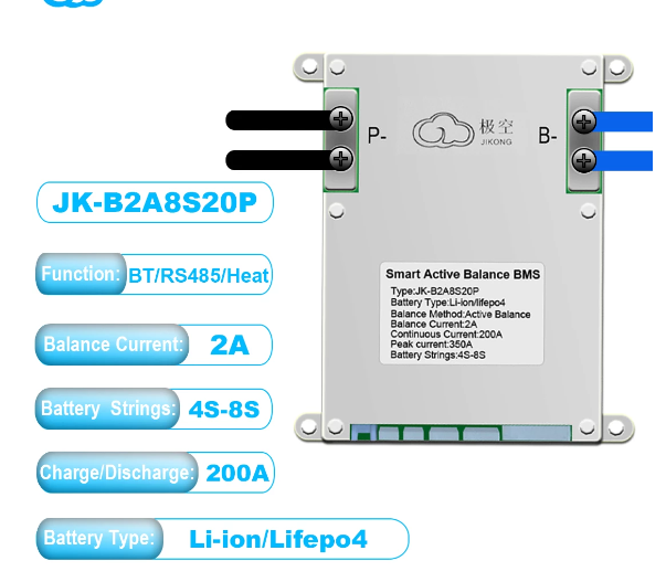

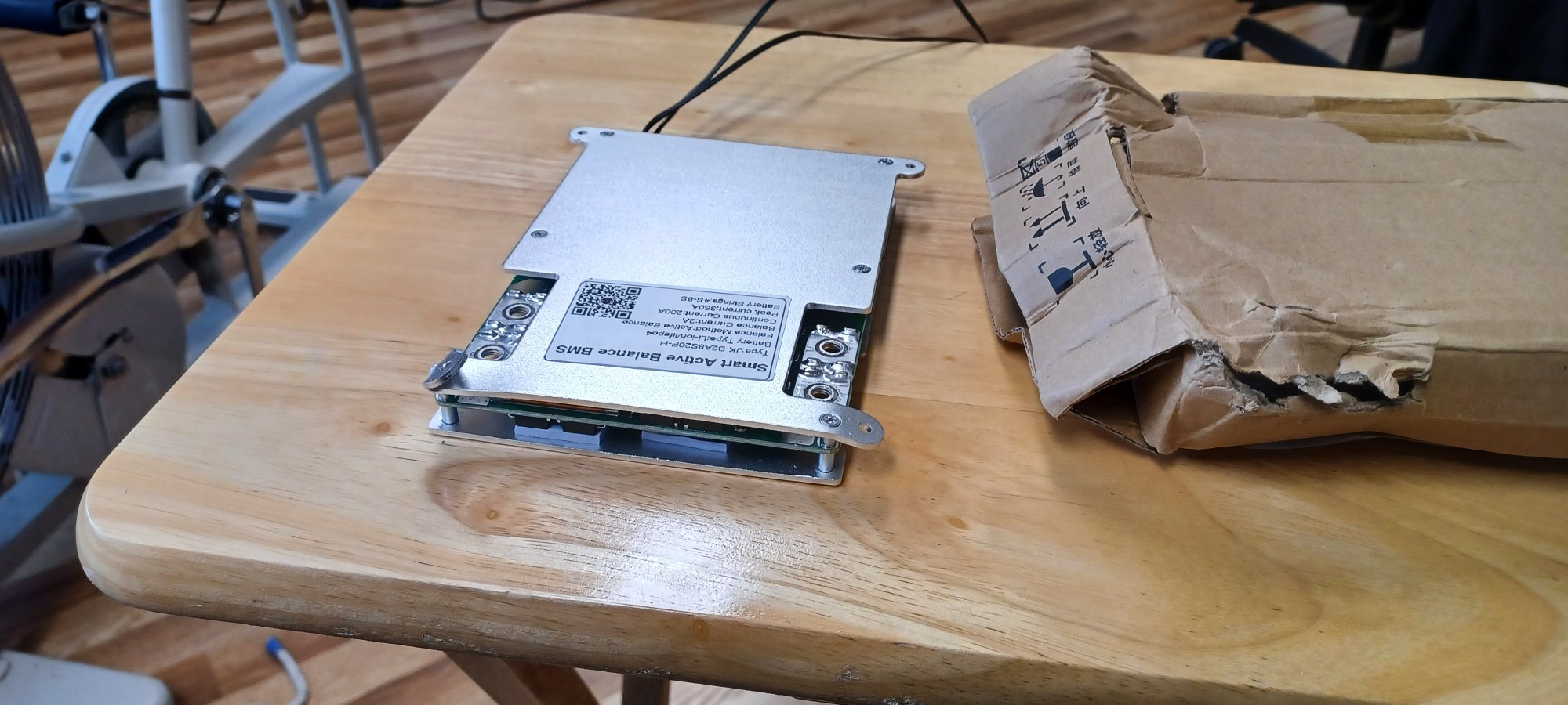

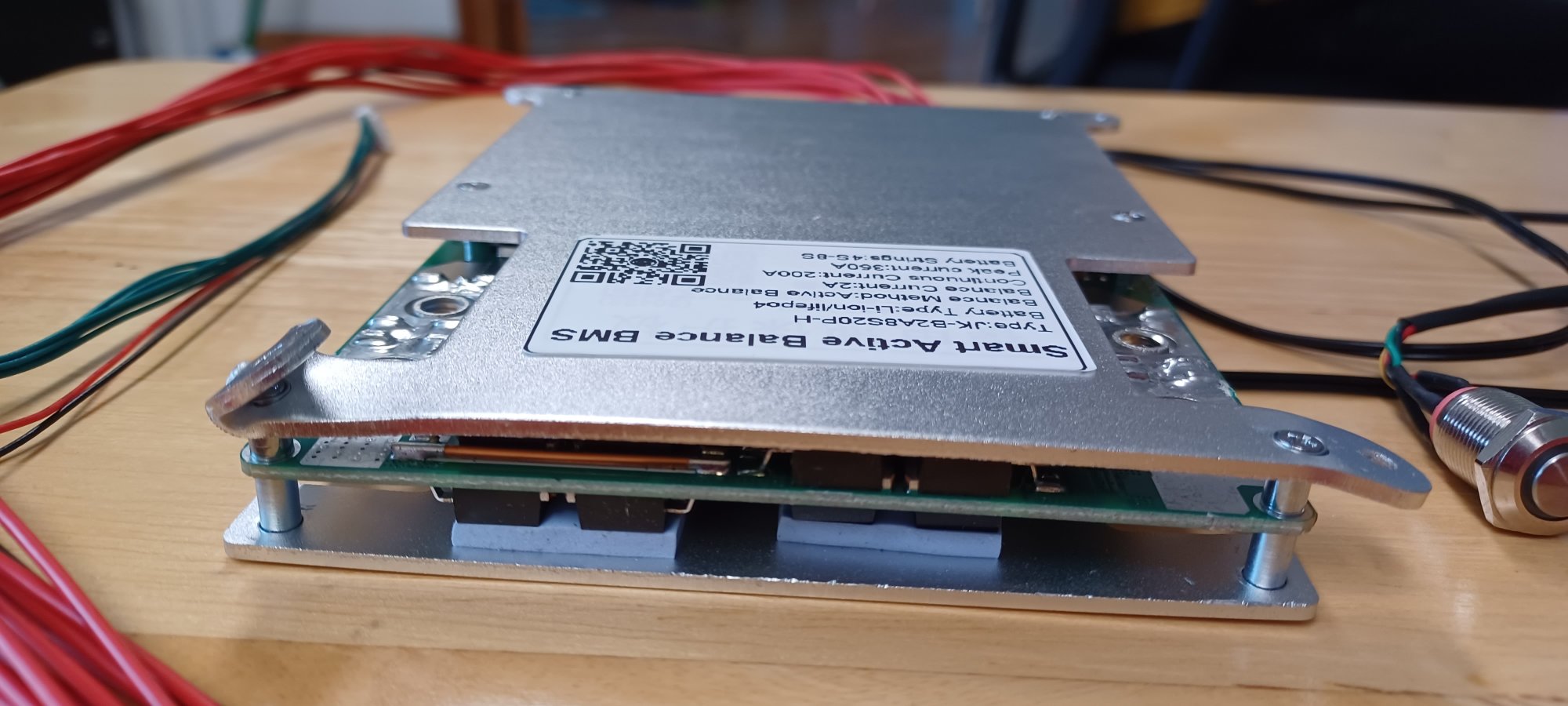

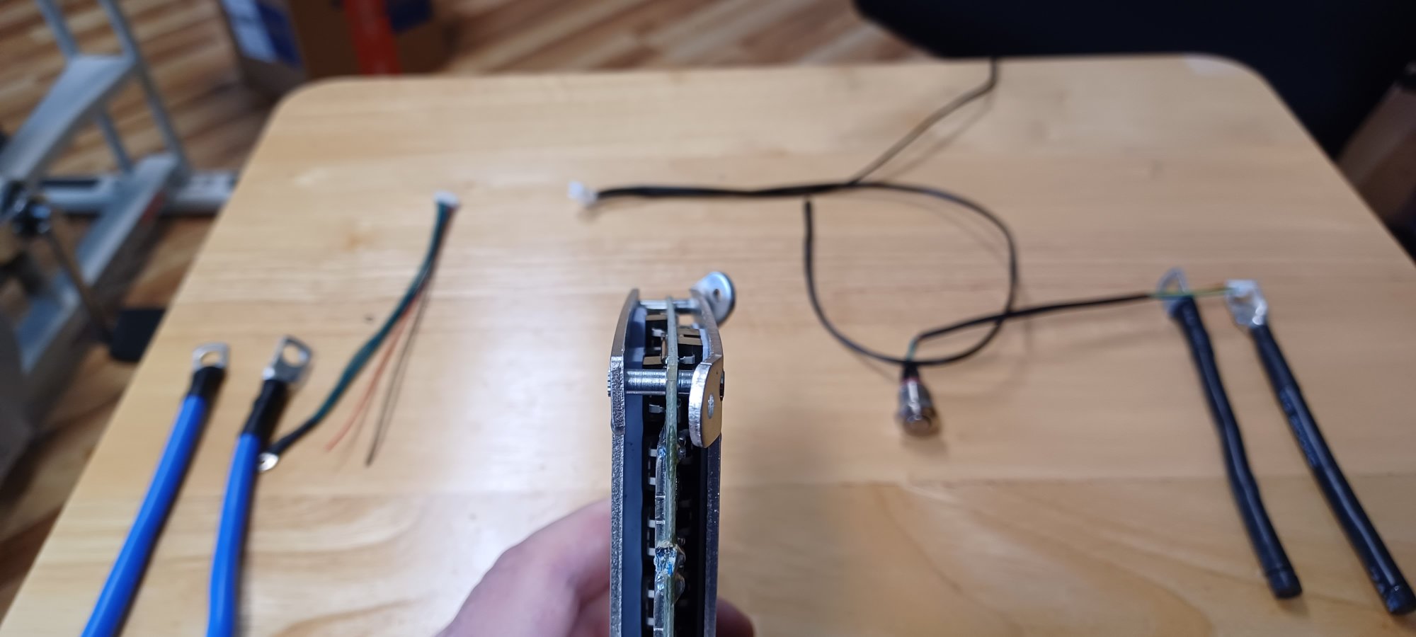

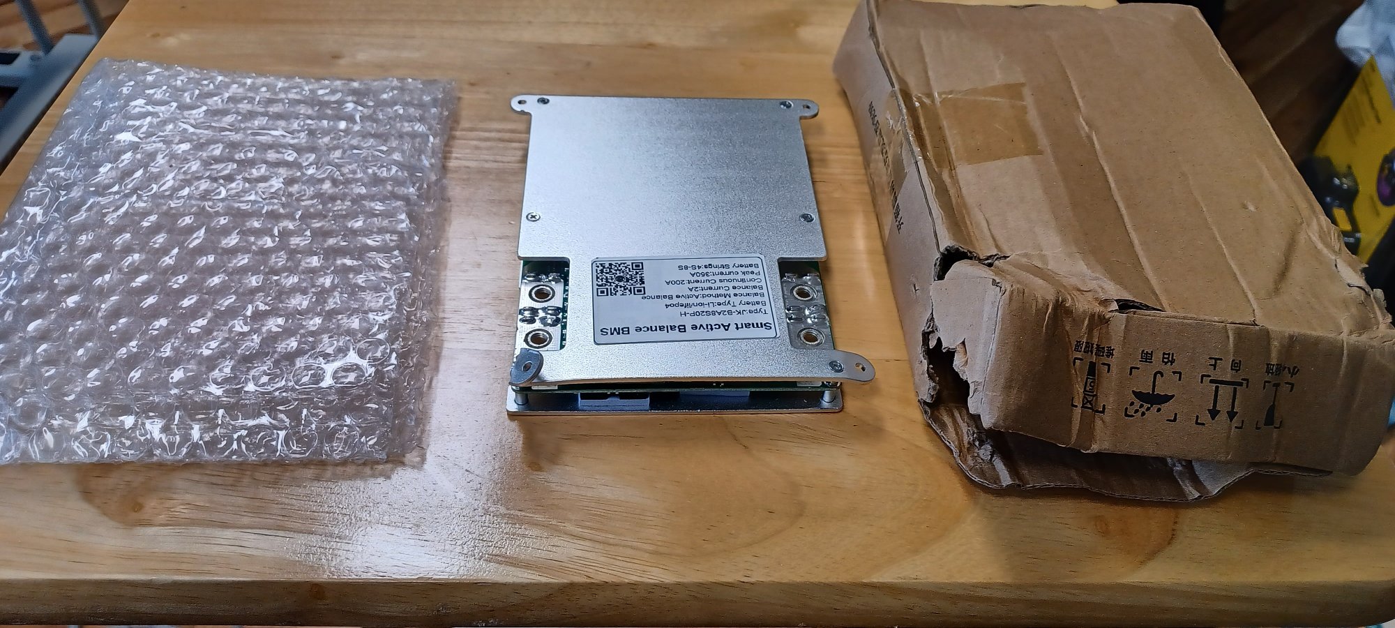

- 4s JK BMS with 2-amp active balance and 200-A charge/discharge capacity (350-A surge for 5 minutes)

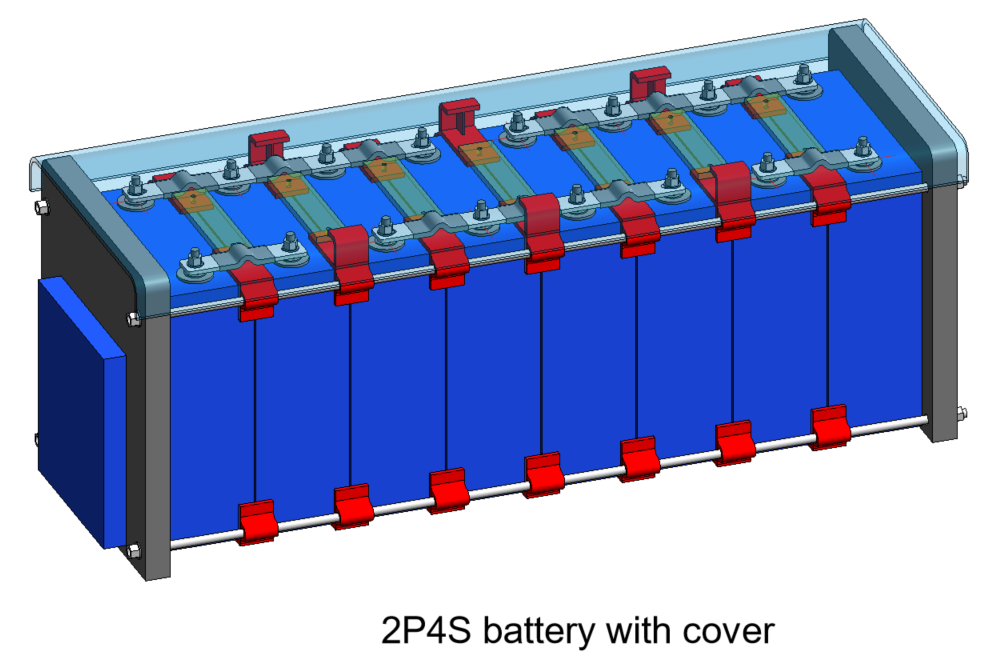

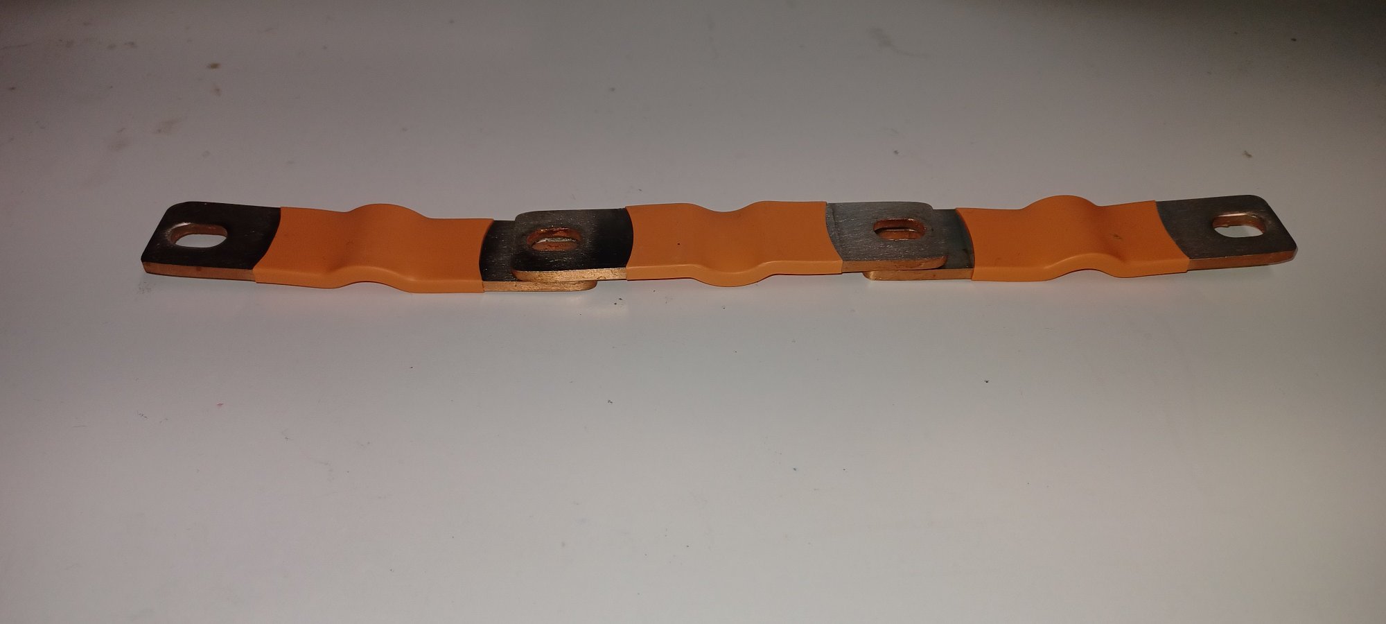

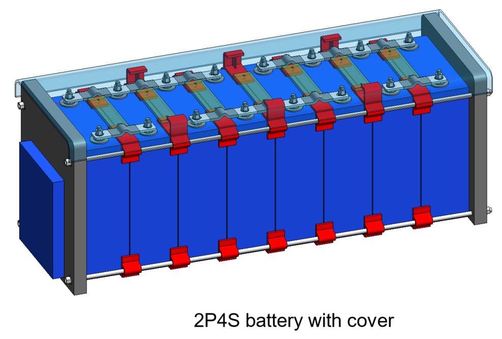

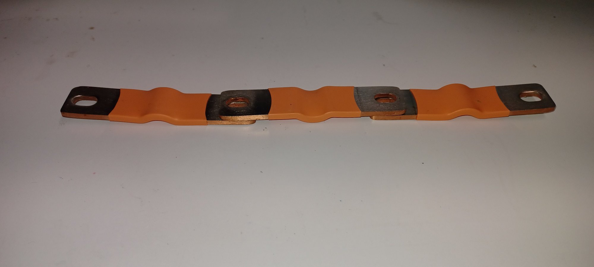

- Flexible multiply buss bars for 2p4s configuration
- 3d printed corner pieces to create 2mm space and secure the four corners from moving. (fixture, not compression)

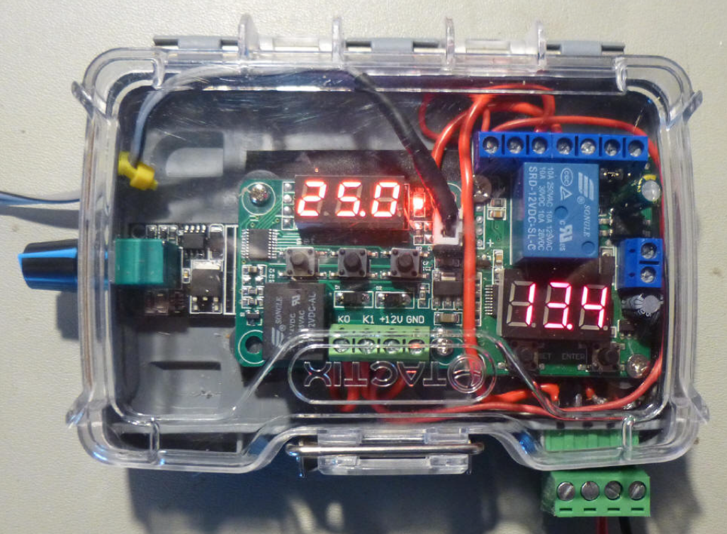

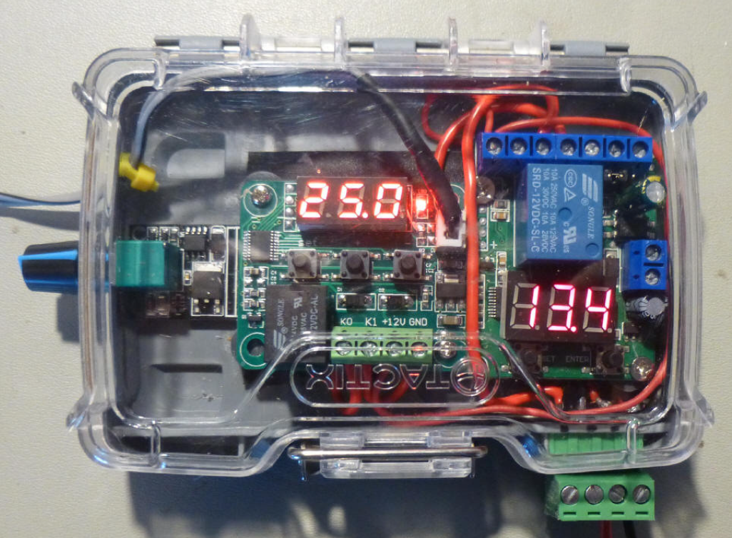

- The bits and bobs to create the "a simple DIY alternator charge system for lifepo4 batteries (12v system) on boats" from Wout Beekhuizen.
- PWM controller to limit output
- Voltage switch to turn on and off as needed.
- Thermostat to shut down alternator if it gets too hot.
