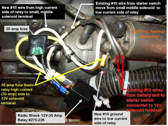

Could be the very common problem of aging or corroded connections in the wiring harness. I would first try a thorough inspection, cleaning, and tightening of all of them. If that doesn't work, you may want to consider replacing the entire harness, or a quicker and cheaper fix: installing a 12vdc relay on the starter solenoid. See attached pic of that fix.

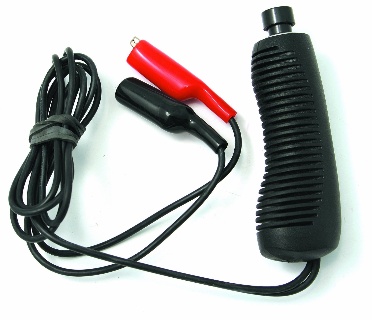

You can get a jump start switch (see picture below) at any auto parts store and bypass all the cabling except the power to the starter and the ground. It is also a good back up should your start button fail. This should tell you where to look for your loose connection. If the starter still won't work with this switch and you know the starter is good, then go for the ground wire and or connections at battery and on the leads to the starter at places like selector switches.
Crap .................. I've been toying with the idea of hard wiring a remote starting switch at the engine for some time now. Would make working on the engine so much easier, rather than crawling up and over the engine into the cockpit to start the engine when required.
And then an idea is presented which is so bloody simple and so bloody basic it kind of tarnishes your self confidence a little bit.
Thanks and on my way to pick one up this morning.
