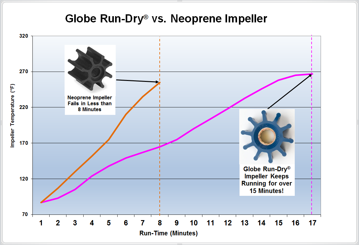

The wife and I just test fired Impetuous' engine after 18 months on the hard, getting ready to splash on Wednesday. A bit of glow plug preheat and it fired right up. Shut it back down because I didn't want to really stress my "run dry" impeller that much.
May 25, 2012
4,338
wayne, just 1 second can tear up a dry impeller. sending chunks towards the exchanger. please check impeller before you splash. ten minutes now could save you big headaches next week.
rule number one: never ever ever spin a dry impeller. never ever.

Run-Dry ® Impellers
The OP said " I didn't want to really stress my "run dry" impeller that much."
May 25, 2012
4,338
and so we learn. after being used and then sitting 18 months. what are the stats on that?
