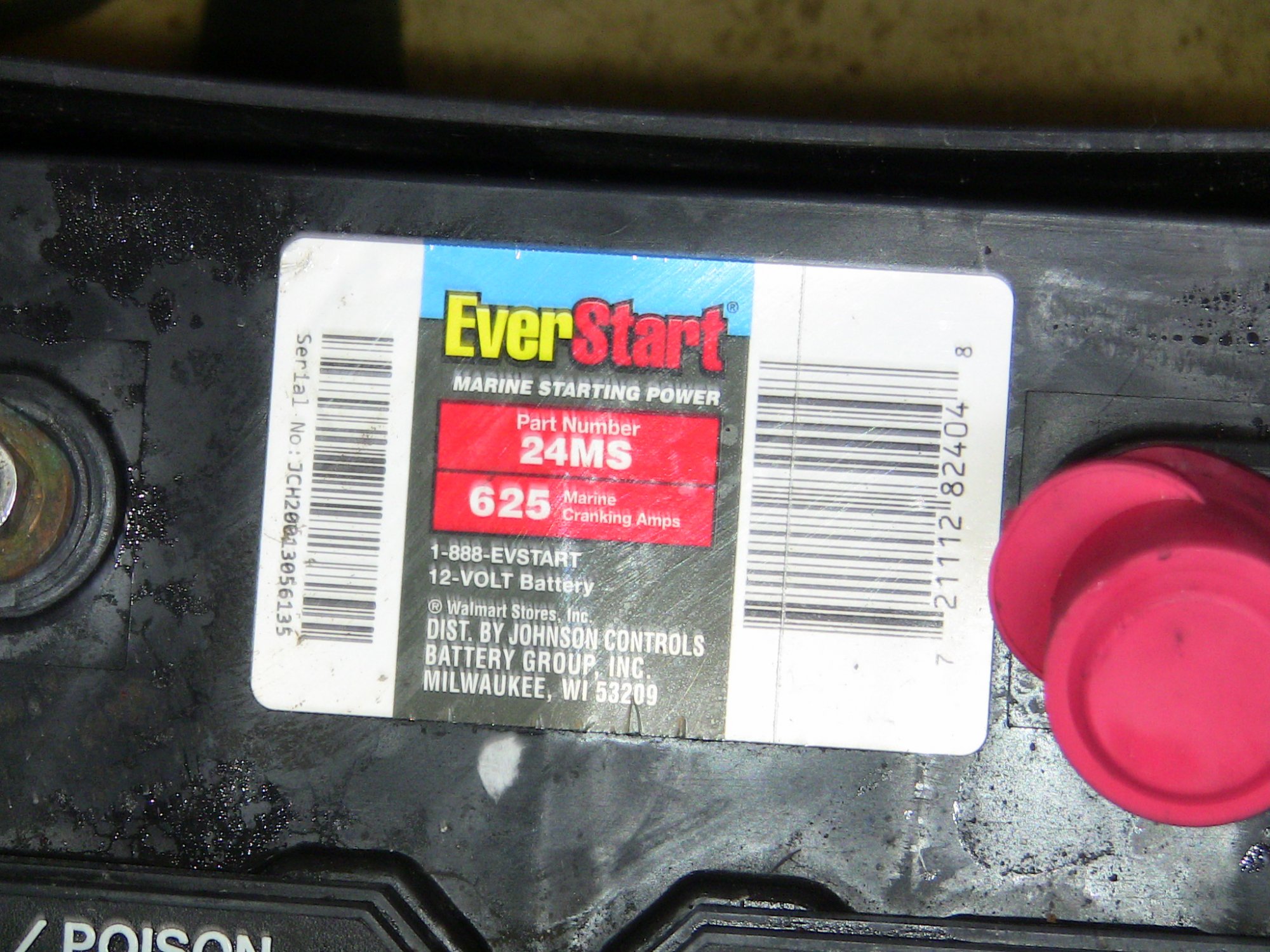

I looked up my 50hp Engine CC amps needs. Mine boat has separate switches
1) Start Battery
2) House Batteries
I buy my Start Battery [Lead/Acid] from WallyWorld for $88, one year warranty.
Jim...
