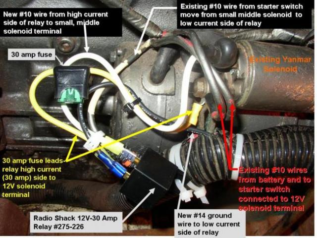

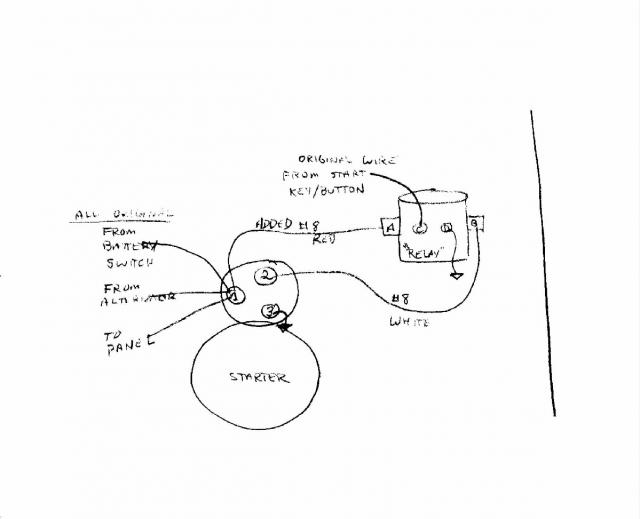

Can someone provide either a picture or drawing of exactly where on the switch & solenoid this continuous wire should go? I have looked these parts over several times and remain uncertain of what to do.
Thanks
Rich M
Nov 5, 2007
74
Hunter 28.5 Annapolis, MD
Thanks Dan, this clears up most of my confusion & I think I can follow the provided diagram and photo.
