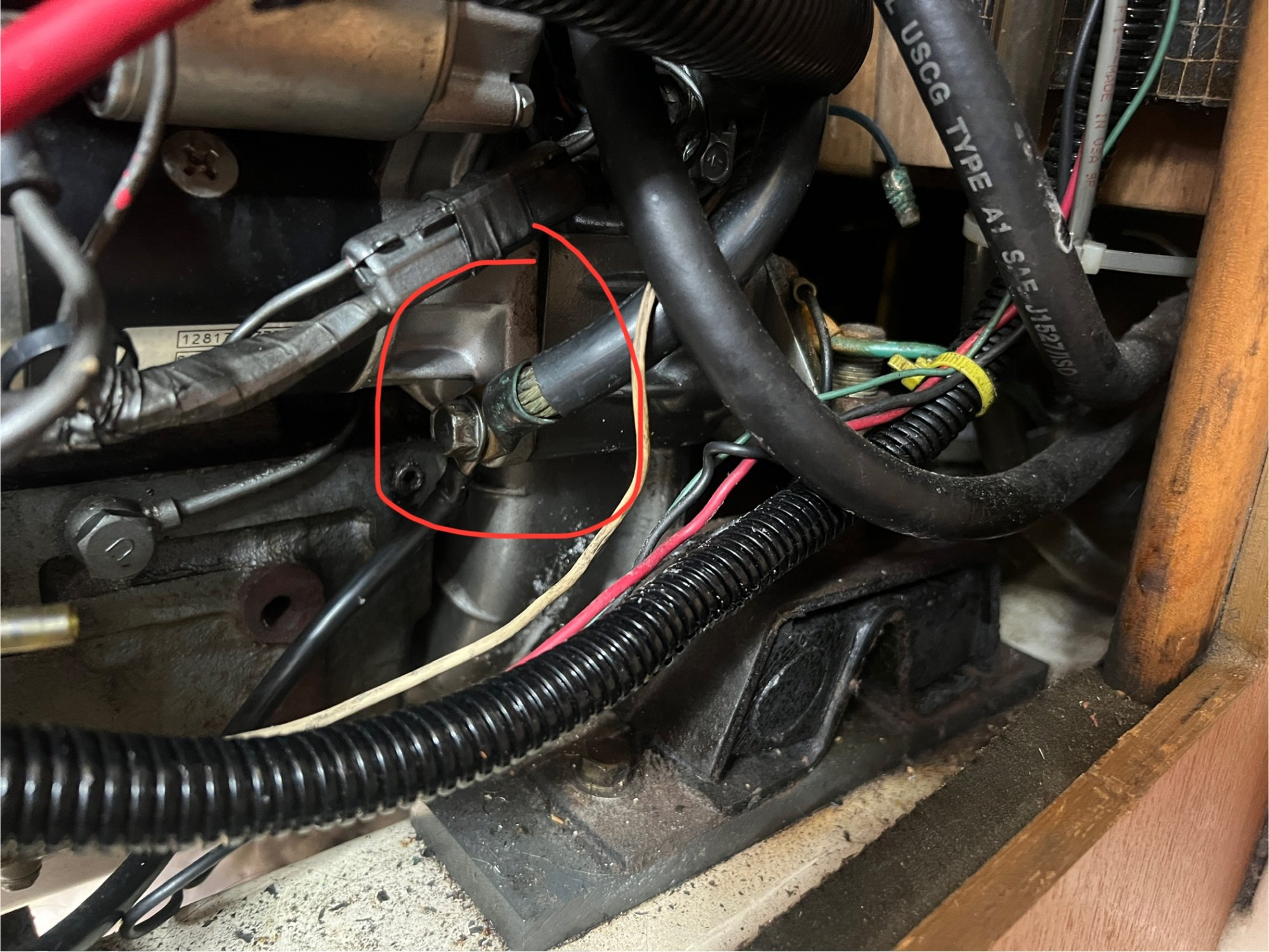

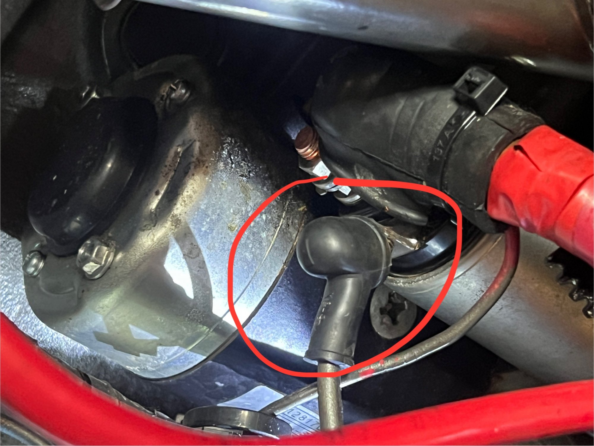

I see a thick gauge white wire (which seems to have been painted with engine paint at some point) going to the solenoid. This is the suspect wire coming from the starter switch, correct? It is definitely larger than 14 gauge. Does this look like it was already replaced by a PO?
I am getting 10v continuous at that wire when pressing the start button.

The wire starts at the battery connection to the starter. It should be on top of the red battery cable. If I recall correctly (its been a few years) the white wire goes from the starter connection with the battery to the key switch, when the key is turned on it powers the start switch which returns to the solenoid.
The drop in voltage is probably caused by the wire size, length of the run, too many connections and some corrosion or poor connection, it may also be any combination of these.

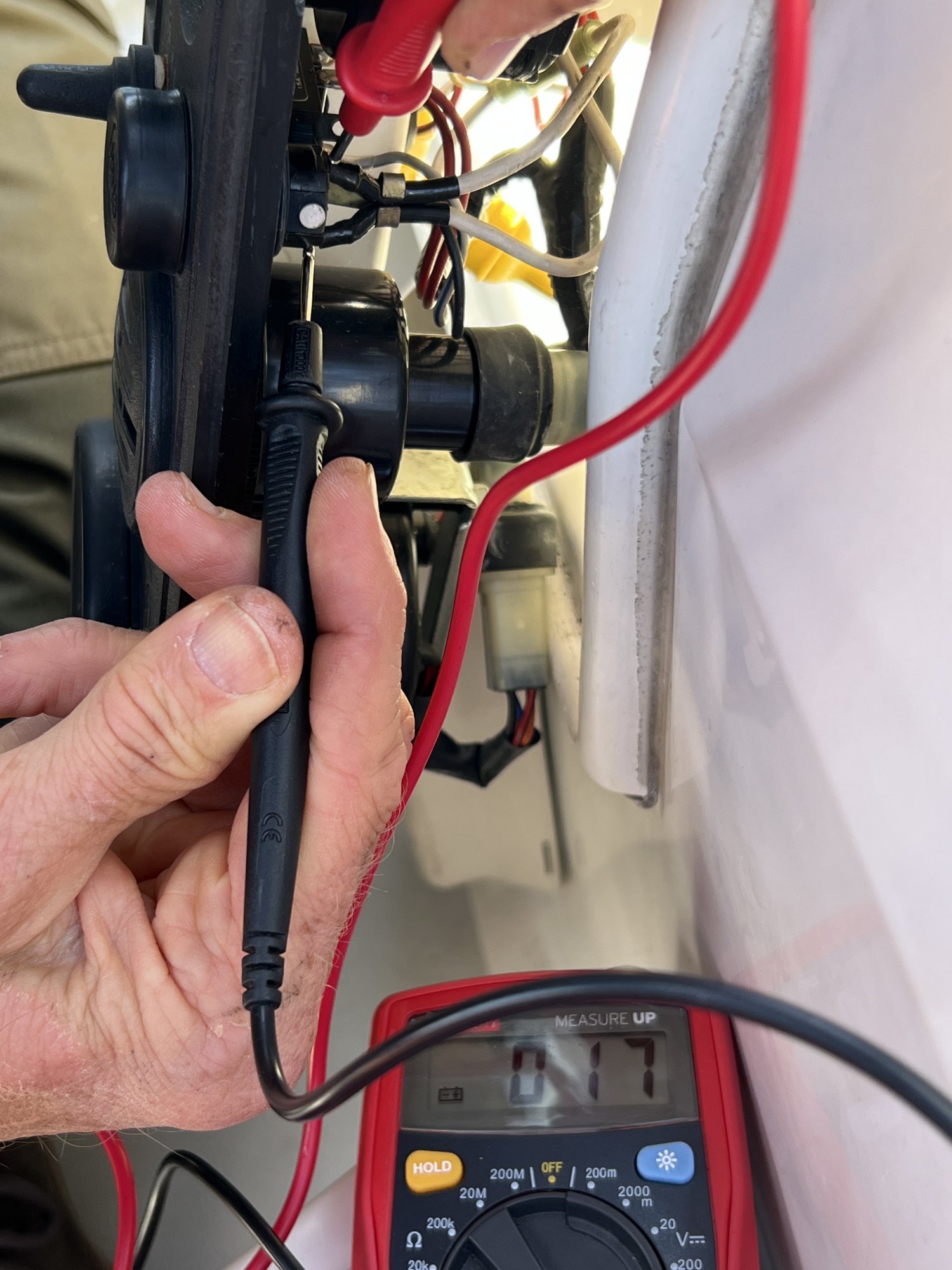

Also, and I’m having a hard time understanding this: when I test the terminals on the back of the start button for continuity, it shows continuity without the button even being pressed. However, the button does work 95% of the time so I’m confused why it would constantly read closed continuity when the button is not being pressed. If it is shorted, wouldn’t the engine crank simply by turning the key into the on position? What am I missing here? See attached pic of meter reading (017) when testing continuity of button.
