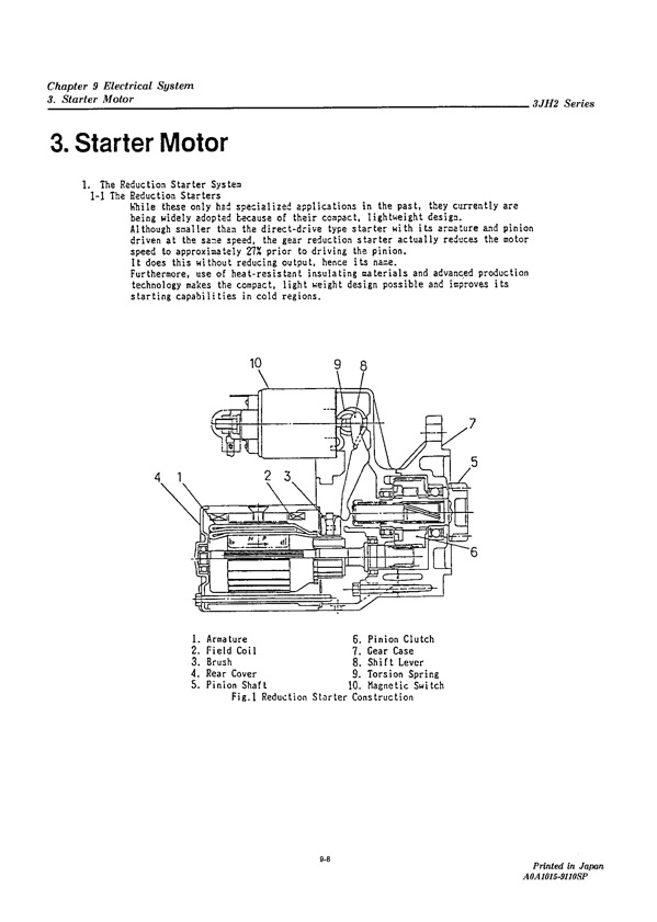

Still the same problem. The solenoid does 2 things, it makes the connection to provide power to the motor and it engages a pinion gear. If the pinion gear does not engage properly power is not provided to the starter motor.
Here are a couple of pages from the shop manual for 3JH2E on the starter. Yanmar uses the same system on most (all?) of it marine engines.Starter Motor.jpg

Measure voltage on 12v input cable to the starter cable while starter button is pressed. It should read battery voltage 12v. If not then the contacts of the solenoid are bad. You can abandon the built in relay and install an external 80Amp contracts relay. You can measure the voltage across the power cables when starter button is pressed. It should be zero, if not, then bad relay contacts.
13,256
The Yanmar solenoid is not a simple contact switch, it also drives a lever to engage the pinion gear. Take a look at the documentation I posted.
Thanks for that info. I did not know that
The idea is to eliminate electrical problem before removing it for mechanical problems.
