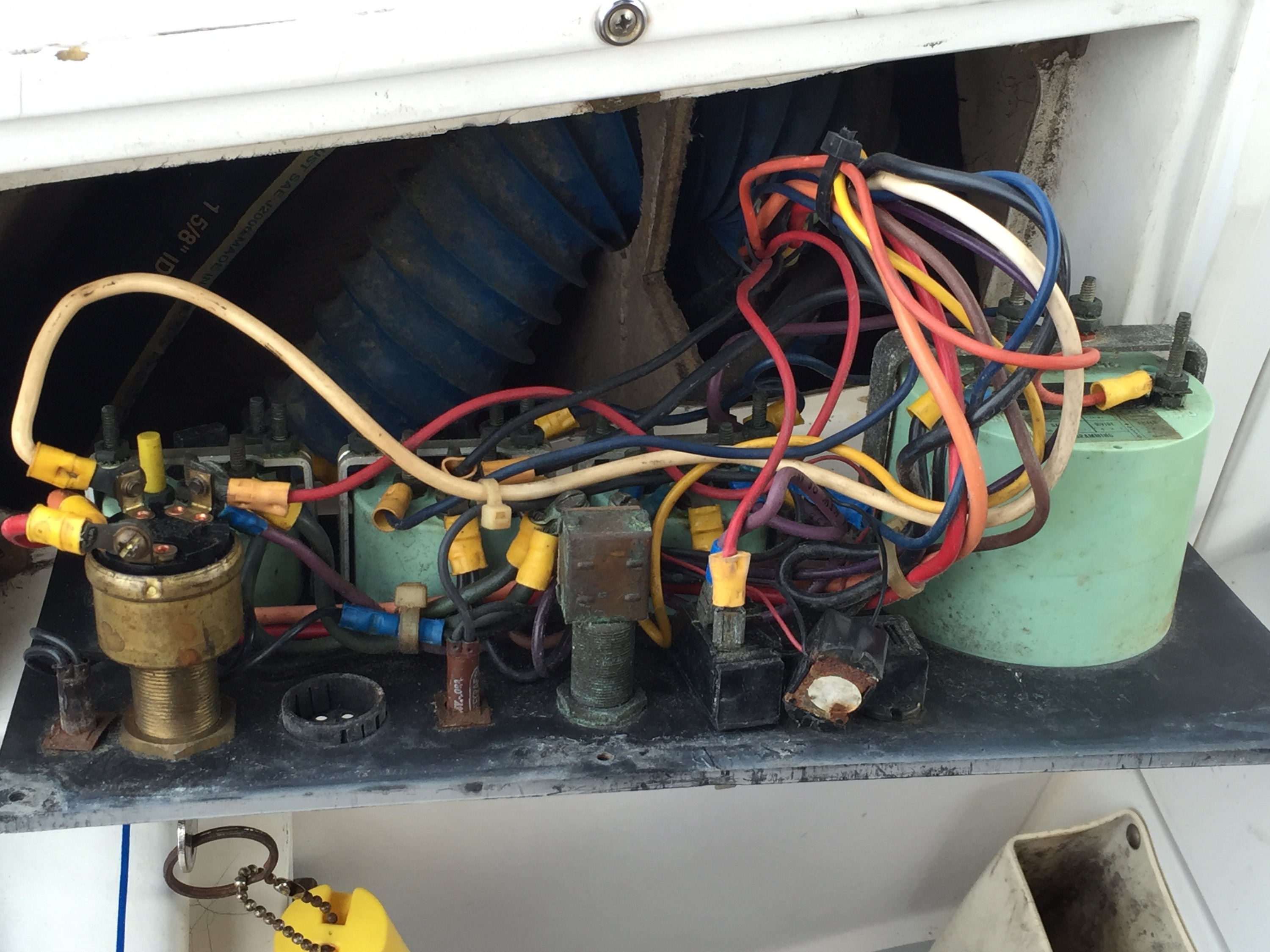

Starting my 1989 C30 can be inconsistent. Sometimes I warm the glow plug for 45 seconds and it starts, other times I have warmed it repeatedly for a total of 2 minutes + to get going, in Florida climate.
This weekend after 45 minutes of trying different things, I ended up having to be towed-in because it would not start. As soon as I entered the slip......it started. Three days later, I visited the boat, no luck. 10 minutes later it started repeatedly.
I opened the instrument panel and everything looked normal, except the small black component wired to the starter button which was just dangling. Thinking of replacing the started button, perhaps its too old. What about the dangling piece, what is that?

You might be getting intermittent connection. Those terminals on the back of your panel look mostly green and black. Cleaning up all the contacts and then coating them with dielectric grease would be my first step. And what looks like the hanging bit with the small plastic box on the end looks like an alarm module?
24,775
Looks like the Spaghetti wiring on my panel. Suggest you look for a ground wire not connected or partially connected. Replace the connectors with proper sized ring terminals and follow Capt Scotty's suggestion about dielectric grease. Perhaps it is time to rewire the boat.

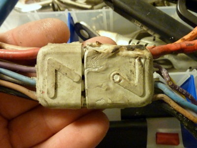

Ok this is a common issue with your motor. Check the inline fuse holders for corrosion. Also check the wiring harness connectors between the engine and control panel. They look like the attached picture. Except hopefully not melted.
One question: if you jog the starter button, is there a clicking noise? Try rapidly jogging the starter button with the glow button held, and see if the starter catches.
There's no need to hold the glow button longer. There's no timer or anything that would help the engine start. The only connection is that it's electrically required that you hold the glow button in order for the start button to work. Probably.

First of all, none of the wiring on the back of that panel looks satisfactory to me. The connectors are all obviously non marine grade and look like something one gets at the discount auto store. Marine connectors with shrink wrap and coated in a dielectric is something sorely needed. I would also suspect based on the portions I can see that the wire is corroded as well. Good Luck with your project. Make sure you use a professional grade ratcheting wire crimper tool. The ones you buy at Harbor Freight don't do a complete job and will leave you with unsatisfactory crimps. I know the marine grade connectors are more expensive but it is a true case of "pay me now or pay me later". I will add that I would agree with those that are suggesting that it might be a bad ground wire. FYI, you can find the wiring diagrams for the panel online in various places. I would suggest an internet search. Again, Good Luck. Don't be afraid to ask for help here. Lots of good folks here. I might add, watch out for the Frog. :kick:
