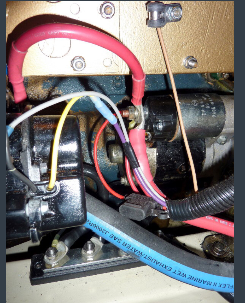

Here is a photo that I ripped off from @mainsail under the universalwire harness upgrade article. I believe this was his M25.
You can see the ATG holder (smallest red wire #14??) in the center of the photo with the protected end going behind the large red cables to the solenoid terminal. This is the extent of wire the fuse protects.
The #10 wire (fatter small red with yellow ring terminal) at the top of the starter lug is the one I’m proposing putting a 30A fuse on, because it could deliver up to 300A if there was a short further down the wire.
As you read in the article that fuse is not replaced to protect that wire, in that location, I install it in that location for two reasons.
#1 If the start button sticks, and they can and do, far too often, pulling that fuse kills power to the solenoid. Pulling the fuse at the engine panel end is often far too difficult in an emergency situation.
#2 An ATC fuse holder, in that location, makes a great tap in point for a remote start button for engine service work such as oil changes, fuel filter changes or "bumping" then engine over for valve adjustments.
Absolutely! That wire needs OCP, and on newer engines it has it.. On that engine, (not my engine BTW) there is a MIDI fuse mounted a few inches away. Because the distance was more than 7", to get to the MIDI, the wire is encased in heat resistant loom.
