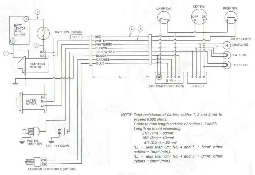

Tony, it seems as though most mechanics these days - either land or marine - have become "parts changers". And if they should end up replacing ALL of the parts and it STILL doesn't work, then, "well... you'd just better get a new boat, 'cuz that one is...".Anyway, look at it this way, there's no magic here... it HAS to be something! Check the following:1) Does the solenoid 'click' when you turn the key?2) Is there a neutral saftey switch in the line that prevents the engine from cranking in gear?3) If the solenoid clicks, then (assuming the battery is OK!)... 3a)your problem is somewhere in the heavy wire leading from battery to starter or the solenoid relay itself, or...3b)You could have a poor negative (ground) connection to the engine block, or...3c)the starter could have a bad winding or loose brushes (even if it WAS rebuilt!). You can sometimes find this by whacking the side of the starter motor while someone else has the starter switch engaged (BE CAREFUL- WATCH YOUR HANDS/CLOTHES/FEET, etc.!!!!!)4)If the solenoid does not 'click', then try hooking a jumper from the battery + directly to the SMALL terminal on the solonoid. If the relay inside is good, then it has to energize. If it does energize, then all you have to do is trace the wires back from the solonoid to the cockpit starter switch to locate the faulty item.This stuff does take time which is why most mechanics are loath to do it! At 65 bucks per hour, you'd freak if a guy spent 20 hours fixing your starter! Also, beware of the devilish "INTERMITTANT FAULT" (my personal nemisis!). One more thing: don't be surprised if there are more than one problem! Above all, be patient. If you find yourself becoming aggravated, take a break! You'll find it for sure! Hope this helps...Jim Maroldos/v: Lil' Wass Ett
