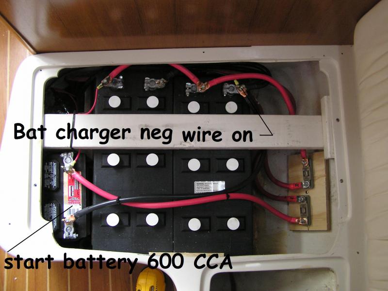

I think it will fit next to the 4D's, but that's where I put my ACR. I put the starter battery just forward of there, in the aft section of the port storage area. It's easy to get to there, and the new cable runs are short.
Feb 6, 1998
11,764
It fit fine on our 310.... This was taken during the fitting out process. My biggest frustration was that Catalina did not leave enough height for 6V batts...... I really dislike 4D's.....:doh:

Battery Box for 4Ds
OK, so it looks like MaineSail's and Paulj's C310 don't have the built in battery box that I have. Or did you cut it away?
I guess I could do what Tom J suggested and put the starter battery in the below the settee storage. Do you have any photos of your install you would care to share.
I think my first step is going to be getting a battery box for the starter battery and seeing where I can get it to fit.

Our was a 2005 and did not have a battery tray. What you see there is how she shipped from the factory. The 4D's were also not in battery boxes which is a violation of ABYC standards for an ABYC builder. Because the battery compartment was open to the bilge it requires "containment" of any electrolyte spillage.... Still, she had a nice ABYC sticker on the stern insinuating she was ABYC compliant..........;):D
We did not keep the boat long enough to kill the 4D's. Unfortunately 6V batts would not have fit, height wise, unless I went with the Lifeline 6V GPL-4CT, which I would not have done, because they are AGM...
When the 4D's died I was going to install 3 or 4 US Battery DCXC 31's for a 390 Ah or 520Ah bank... IIRC my measurements this would have allowed for all batteries to properly "contain" the acid in plastic battery boxes.
