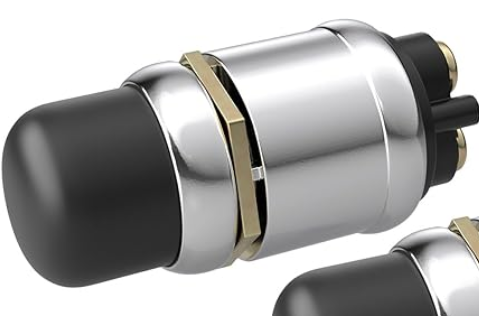

I used this push button switch on an outboard for three or so years before I sold the boat. It's rated for 50 Chinese amps so I'd estimate at least 25 real amps. Zero issues even though it may have occasionally gotten dunked. It's available in red as well. Connect this in parallel with your existing switch.

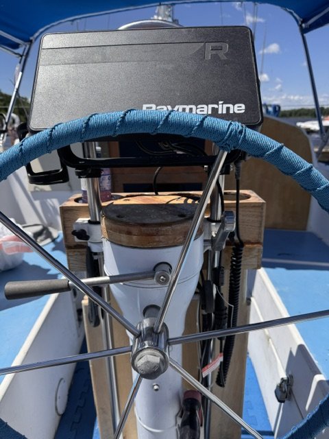

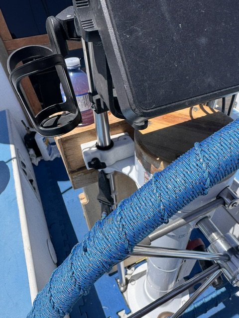

I finally had the time to go to the boat and I actually remembered to take pics of where the button would be good.
Option A: under the plotter, maybe a plastic electrical box screwed under the plotter support?
option B: second picture, near the wood drink/binocular holder and the tubing
if I do option A: I might have room for the ignition key as well, yes more wiring but a lot more convenience. Not sure about the key yet
I'd love to see integrated into the wood where a compass would normally be but that's a lot of work to secure the wire inside the pedestal.
I believe the push button switch fits into a standard junction box hole. When I installed it in my outboard, I used a couple of large washers to adapt it to the hole in the motor housing. You could use some multiconductor wire to add the key switch to the same box as the starter button. Try typing in "plastic junction box" into amazon to see if any fit your needs
