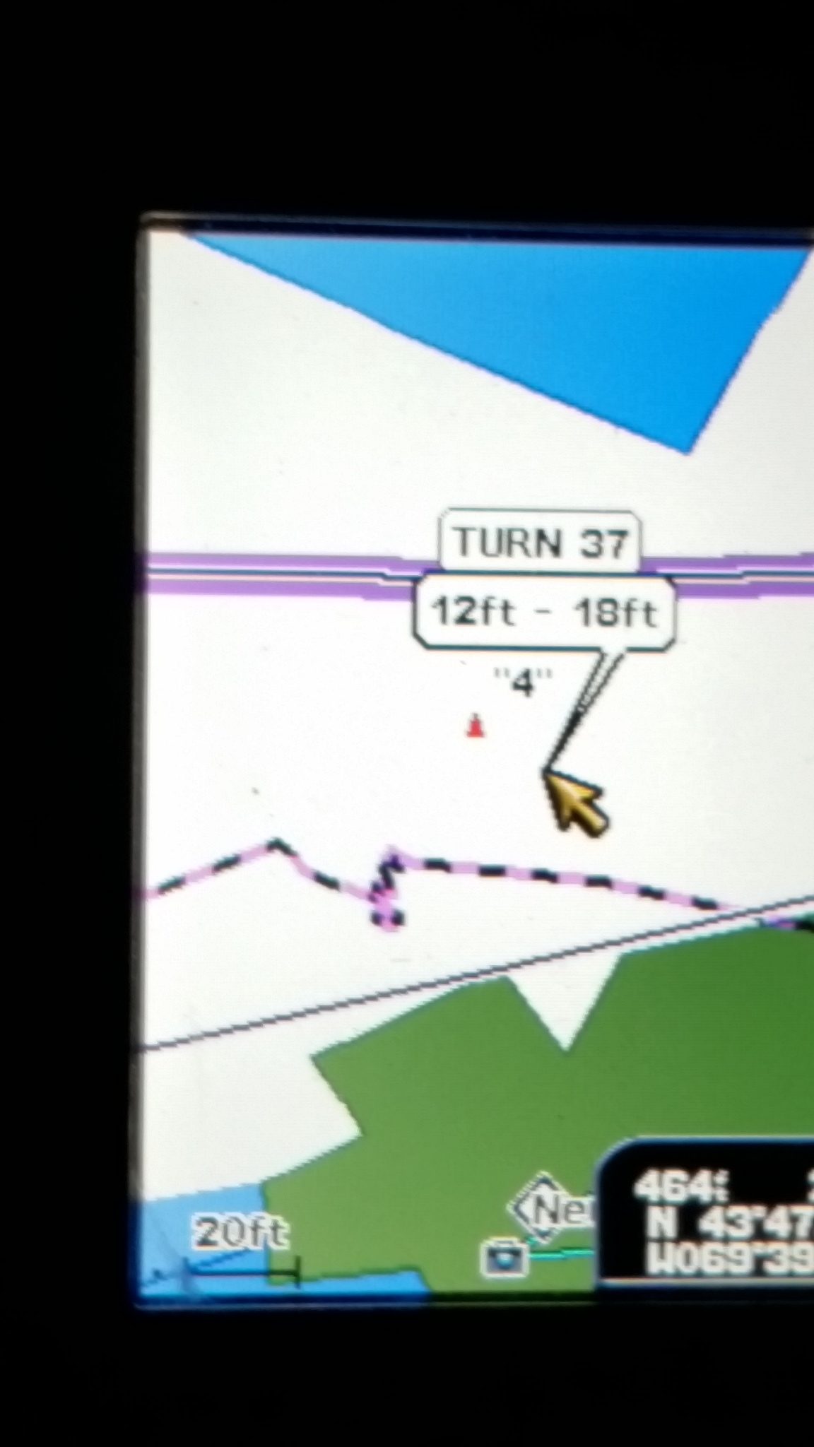

2. Arrived 3:00pm at Harbor and proceeded into channel and went up on rocks at the mouth of the channel. Chart Garmin did show 12-18ft. at low tide so thought I was safe. verified with active Capt. all good. NOT.

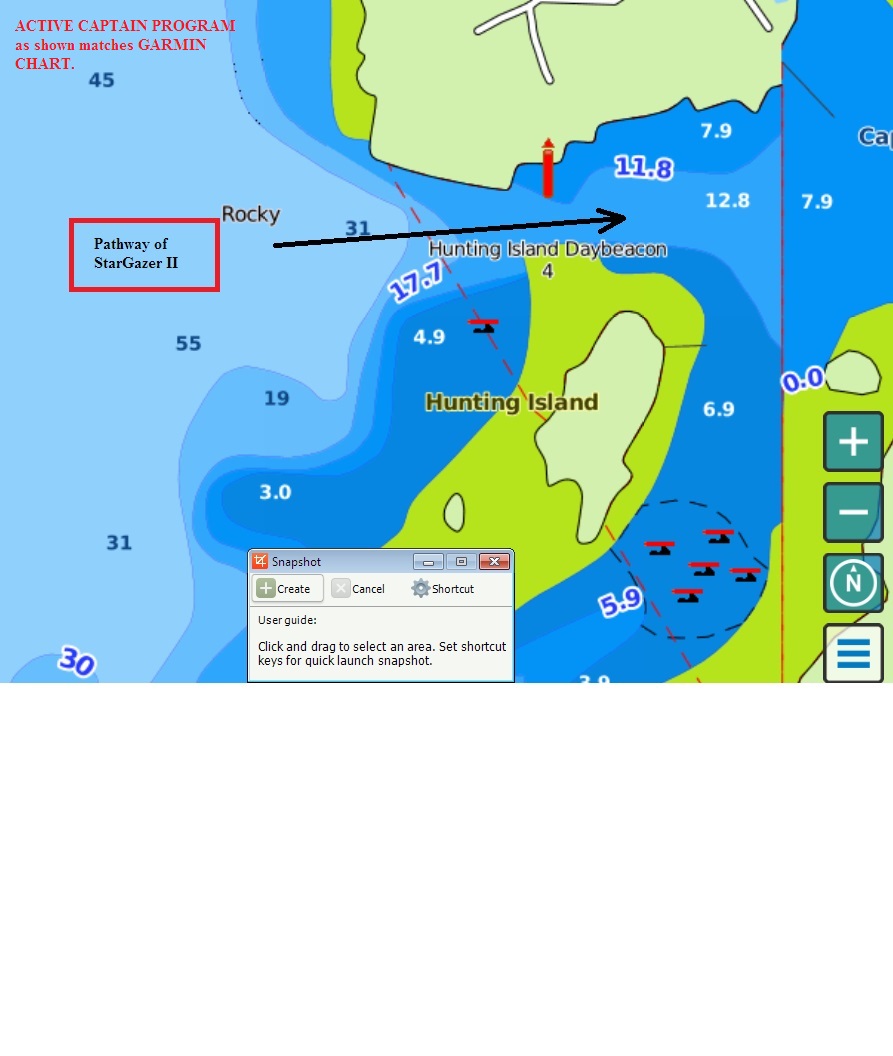

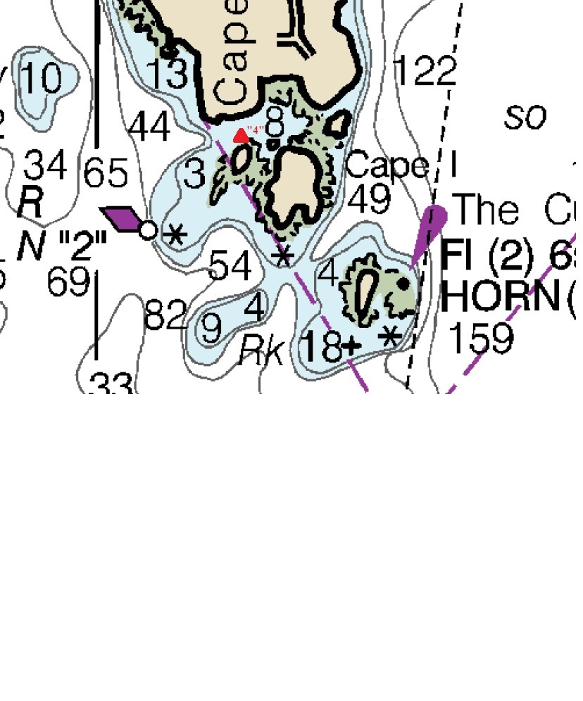

Thanks to all for your support here! Right now I'm working on 3 projects, 1. With a senator of Boot Bay drafting a new bill to become law against traps at all entrance of Maine harbors or obstructions preventing proper navigation by vessels. 2. Garmin charts error's. Right now Garmin's charting company with NOAA and USCG is investigating the problems. 3. Dealing with GEICO boat insurance. Oh by the way, My hats off for the speed and progress Geico even during this time Florida was hit with a hurricane they didn't miss a beat. Even after some 2800 claims during my claim. Adjuster came 2 days and checks in the mail and now prep the boat for repairs. I've looked at many insurance company's and for my money you wont beat GEICO Boat Insurance fair and backed by GEICO. NOW! Back to the charts You will see NOAA Chart #13288 showing the rocks to the Day-Beacon. We normally enter RED RIGHT RETURN however, this is not a channel marker like a nun or round red ball marking the channel. As I was going to approach this harbor I went onto Active Captain and verified my course of approach. Both the Garmin and active capt. validated my course. BOOM! you will see the line stop well before the day beacon, To the port side (left) their was close to 30-40 traps making navigations imposable to the left. A typical sailing vessel could not get threw this. The town and harbor master has been given warning to uphold the current laws on their books. They just don't bother. Buy the way Towing guys told me that I was the 6th person this year..lol The one thing that really bothers me is why my new radio from Standard horizon FAILED to report my distress to the USCG. This has to make one think about the systems in place. The hotel call the USCG and gave them my cell number to talk to me and thankfully they didn't need to come However while I had them on the phone I pressed the button while on the phone and again no signal or sign of them getting my signal of distress. But haled them easily on CH16. For me I will always use 16 and not the DCS Button. And by the way I ordered a new radio and its not a Standard Horizon. Capt. Rob

The day mark is clearly shown in the Garmin charting and right red return should always be observed, especially entering harbors in Maine and more especially where day marks/beacons come into play.. NOAA never offered a "zoom" of Cape Harbor so the best chart NOAA has for Cape Harbor would be the right side of 13295 in conjunction with local knowledge and the Taft Guide..
Chart 13288 is wide scale at 1:80,000 and that red day mark is not a NOAA mark, someone has added that. Chart 13293 shows the day mark and 13293 along with 13295 would be a better choice for entering Cape Harbor. The Maine Coast Cruising Guide with 13295 would be best.

You checked Active Captain before the Maine Coast Cruising Guide? I really don't understand why you would choose to go South of the day mark shown by Garmin? If the harbor entrance was blocked by traps we can't move solid granite no matter how much we may want to. Based on your plotter screen shot it appears your course was plotted correctly, to the North of the day mark, but you actually went South of it?
The purple line with black stripe was your plotted course right? If so, that would have put you in the correct location.
