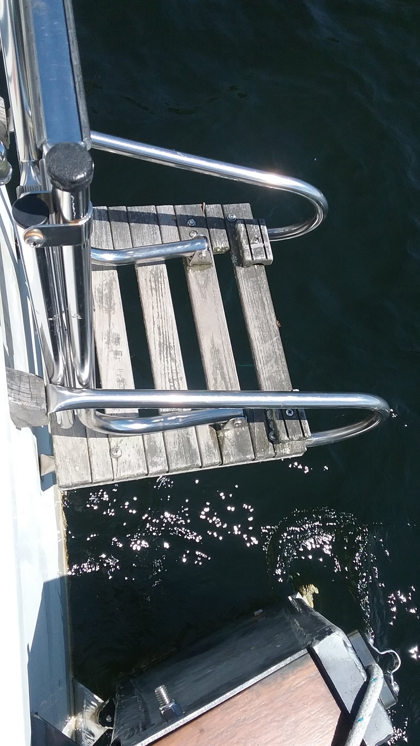

I need to install a new boarding platform with ladder, to my H23. Because of the reverse transom, the original ladder was installed with wood block spacers behind the top arm mounts, so the platform would not tilt up so much at the rear. These are wood blocks about 1.75 by 1.75 by 3.5 inches. You can see one of them in the attached photo - the top end was cut at about a 45 degree angle, I guess for looks. These are cracking, and I want to replace with a composite. To make it a bit more level than it is, I'd go with 2 inch thickness.
Thinking of Starboard, except I'd have to buy a 1/4 in sheet and layer it up (8 layers) to be thick enough (the thicker sheets are too expensive) - unless there is a source for it in a 2X2 "spindle" type format?
Maybe Trex or Azek or one of the composites you can buy at the big box stores? I assume these are OK for UV resistance if they are used on decks?
