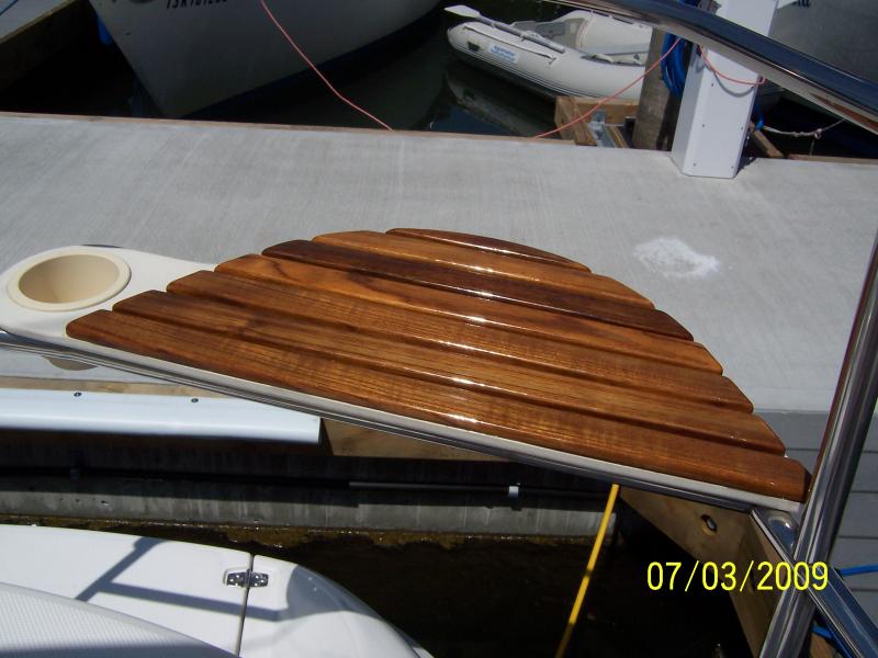

The seats on the stern of most Hunters are starboard with teak wood slats on top and are held on to the stainless frame with screws from under and over the years from removing them every summer here in florida while on vacation up north the screws get loose and I have gone a bigger size but they still become loose and even fall out.
I am thinking of filling in the holes with some kind of epoxy or west system,what should I use to fill in the holes and than re screw into the same holes.

You can buy threaded insets that you can either press, or thread, into the starboard. They are made from brass.
The one you need has a 10-24 internal thread
Now, taking them on and off is a breeze, because it is machine screws: not self tapping thread

Artboas' threaded inserts are your #1 choice for a system where you want to remove the seats every year. Make sure to use an anti-seize on the threads or you'll unscrew the whole assembly.
A second rate solution but perhaps a little quicker is to use a small soldering gun and melt some polyethylene (waste poly object or whatever) into the old holes. Work it in with the hot tip of the soldering gun.
I'm afraid I can attest to the fact that nothing "really" sticks well to polyethylene after looking at trying to attach a flange to my poly water tank. Tried numerous adhesives recommended for poly but none were too reliable.
I did my slats with five coats of epoxy resin a few years ago and they still look like wet varnish today. Epoxy may even withstand the Florida sun but be sure to use several coats of varnish to protect the epoxy.

But I took a great idea some one suggested and yesterday put threaded brass inserts with expoxy and will install today back on my boat,thanks to all and Ralf Johston.
