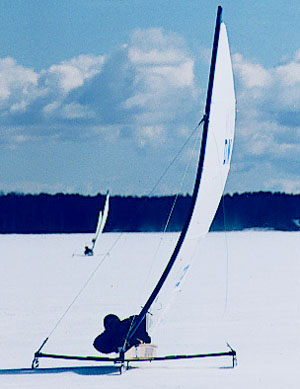

One question I have never really been able to answer myself as I think you could only tell by racing but I see postings noting that a straight leading edge of the jib is important for going upwind.
I’ve attached a picture of a modern DN iceboat rig with a "designed in" bendy mast. This is a very efficient rig that will scream upwind yet the leading edge has a fairly dramatic curve.
So how important is to get rid of that last little bit of bend in the leading edge. I would think that the sail maker could easily take this into account on the sail cut and then it would not matter at all. Hopefully we can get some actual racing experience to answer this..
