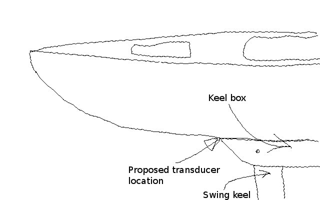

PSS I'm also thinking of mounting the tranducer for the fish finder right at the front of the keel box for the swing keel and routing the cable thru a 3/16 hole drilled thru the hull just in front of the keel box.

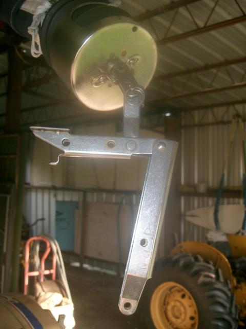

We leave everything taunt and have a Johnson Lever on the back stay. You pop it open, which loosens the rigging enough to pull the pin of the front stay, then lay 'er down. The beauty of it is that the back stay is always attached. It's very cool. I bought mine on Ebay for $35. I strongly recommend it. Have you and the Mrs. stepped it yet?

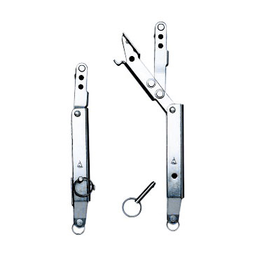

In previous years we had the forestay set with a pinhole adjuster like Joe, then set up the sidestay turnbuckles. We don't have a backstay.
To lower the mast, I'd back off the sidestay turnbuckles exactly 10 turns, then drop the mast... reverse the process to raise the mast. But it's a bit of a pain, and it's wearing out the turnbuckles...
So this year, I've bought the smaller Johnson lever to use on the forestay, so I can reduce tension without touching a turnbuckle. I felt really smart about this til our class association's wise man mentioned that he simply uses a jib halyard to raise the mast and also to pull the mast forward hard enough that he can pin the bowstay... no fancy-schmantzy release required. :redface:

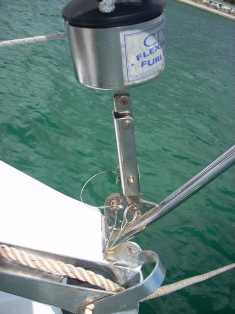

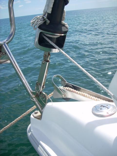

Kenn, Don't feel bad.
Like DS I had also tried to draw tension on the jib halyard just enough to allow the needed forestay slack to pin it but it was still very difficult and was straining the rig so much that the lever seemed like an obvious choice to keep from straining the rig or detuning our rig each launch. Also, as hard as it needed to be pulled if anything had failed it would've been catastrophic. Our lever is the simplest, safest way to save time rigging our boat.
At 36' our mast is on the big size for a trailer boat and from the sound of it your class assc wise guy would have a hard time with my simple 12v atv winch mast raising setup too;) Even the old guys need to be open minded enough to learn a new trick occasionally. keep the lever and have a great season.
