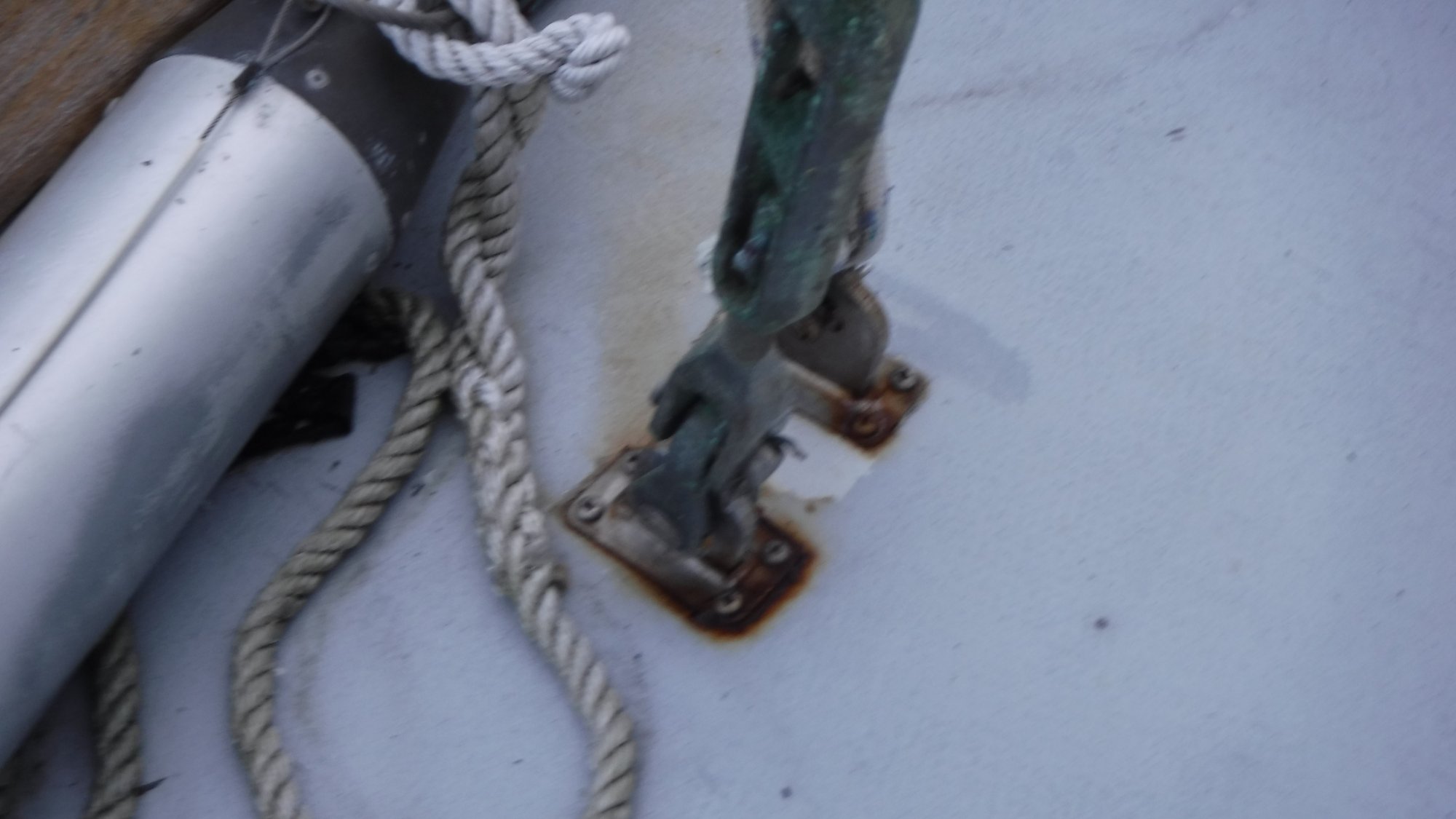

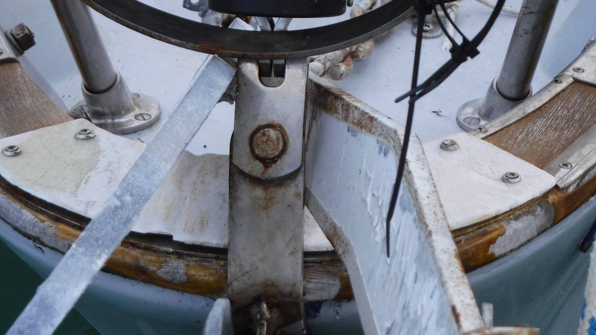

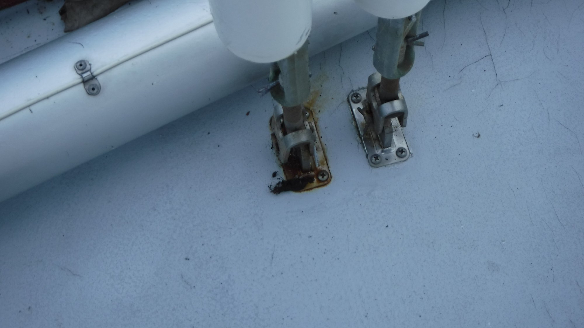

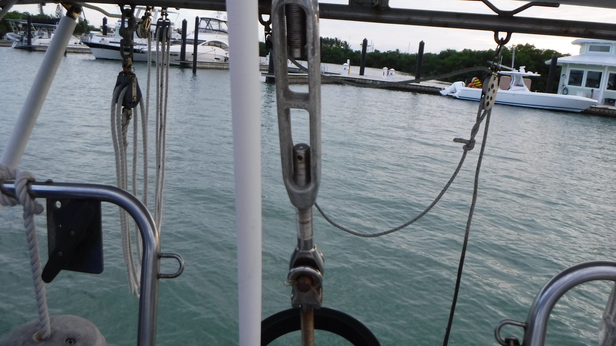

Images of rigging found on a boat that the owner said was ready to sail...
Rust on the Forestay chainplate
Everyone of the covered shrouds showed rust staining on the deck
384F7391-2101-40D2-9F7D-5CC901C5D4C2.jpeg 0BE9149D-1198-45E9-A04F-FFA459BECCB1.jpeg
Back stay adjuster with rust stains
