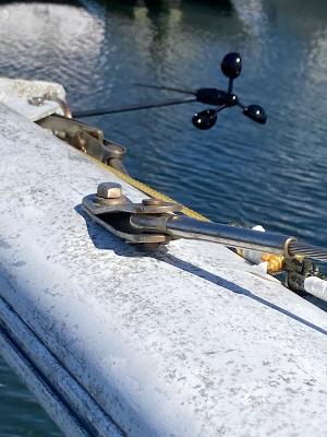

I have Hull #24 of a 1979 Hunter 36 That is having internal halyard issues. Mice made internal nests in my mast and when the mast was stepped out came the Halyards. Now I am trying the "snake" a lead line down the mast (mast is on down on the deck) and I am running to blocking from the mast head about the upper pin. I removed the through mast bolt but could not remove the tube that secured the tangs. Are these through tubes attached? I put vice grips on the tubes, hammered to no avail. Ate these tubes screwed (threaded) together. How can I "easily" run trace lines for new halyards?

Thank you for your response, however my mast head is welded on my mast so no removal. The mast is on the hard but small plumbers snake jams on the through bolt for the upper mast stays. It could be that a mouse/mise nest is still in the mast stuck around the uppers bolt assembly - see the attached jpg in posting. I took the bolt out but could not remove the compression sleave. My question is how do I remove the compression sleave? Any wisdom. I hit it with a hammer while putting vice grips on both sides and could not loosen the sleave. HHEEELLPPP
Goal: You want to clean out the mast and run Halyards through the mast.
TO do this you do not need to remove the compression sleeve designed to keep the side wall of the mast extrusion from collapsing.

Your image shows the mast on it's side as you are working on the tang. Rotate the mast 90 degrees. Use the exit boxes at the mast base to guide your next step. (you need to choose the orientation of the mast based on which halyard you are running. You can run the halyard or you can run a messenger line which ever is easier.) Based on the halyard that is using the exit box, the halyard will pass to one side or the other (front side or stern side of the mast). Using a long extension fiberglass rod or electricians fish, pass the halyard from the mast head to the base. It will ride the inside of the mast tube and slip by all of the compression sleeves which are in the middle of the mast. One either the front or stern of the mast you have a conduit for the electrical wires. This should be attached to the mast most often with rivets but sometimes screws. Just avoid the conduit. You may need to again rotate the mast on the saw horse supports to give your fish a clean area of the mast to slide on and avoid conduit.
