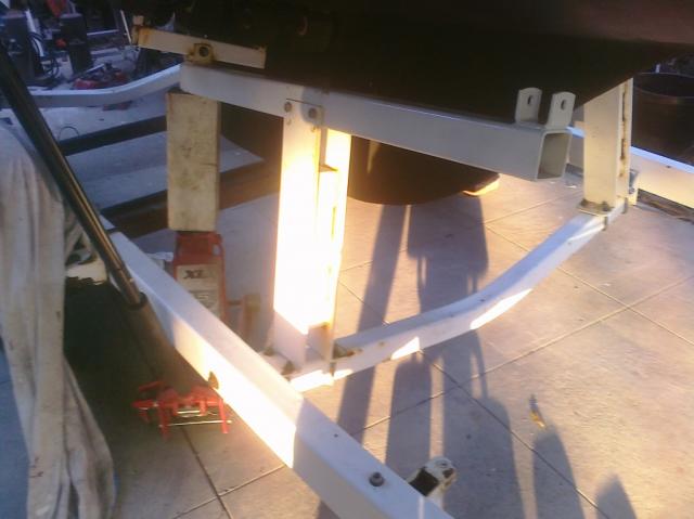

I know what you mean. I started to jack mine up by the keel and chickened out after feeling the weight on the jack. The keel looks so thin and fragile.
FYI, I needed to paint under the rollers so I jacked up the second set of roller and all of the other rollers on that side cleared. It did not take a tremendous amount of force either.
