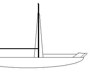

I have the same boat you do and like you I do not have life-lines. I have had them on other boats I've owned however, in the cockpit of the Mac. I have never felt the need for the life lines and I have sailed her is some heavy conditions. The cockpit is narrow enough that you can reach both sides. HOWEVER! on the bow... in a chop... while trying to dowse the head sail....I have felt insecure at times and wished for toe rails and life-lines.
This summer I'm going to run a life line from my bow pulpit to the the shroud. You can use a hose-clamp and a shackle to make a pad-eye on the bow pulpit for an attachment point and use a shroud cleat and a wire clamp to attach the other end of the life line to your shrouds. I've done this on another boat I have owned.

Rgranger, that's a slick idea, running a line from the pulpit to the shroud. I didn't think one was meant to attach anything to them, but I like what you just illustrated, and I'll look into it strongly for the forward deck.
