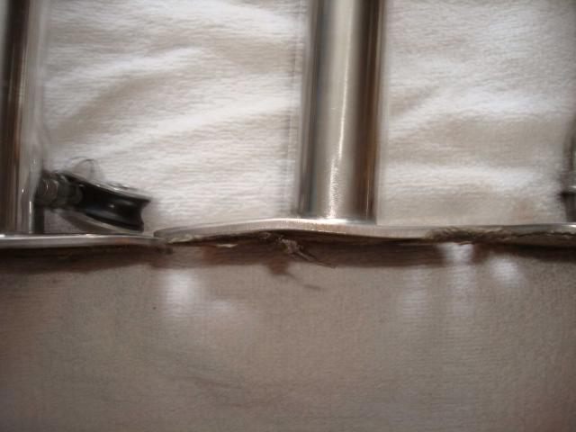

One of the other reasons I was giving this some thought is because of the stanchions in the photos. (Pardon the poor light and my shaky hands). As you can see (hopefully) two of them have been bent, one severely. I'm not too worried about the angle of the bend, but I do want to get the bases flat again so they make a good seal. Between that and sometimes seeing a pool of ice around some of the stanchions from leakage in the openings of the cover (I hate winter thaws), I came up with the idea behind this thread. It seemed like a pretty decent idea last week. Plus, even though I've seen a lot of variations in base shapes and angles, finding that will work on the pulpits might be tough. So I think I'll put those boat bucks in the kitty and maybe have the cover modified to go over the top of the life lines some other day. I wish I'd been around to suggest that to the PO when the cover was first made. Oh well.
