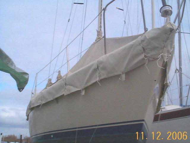

I'm looking for opinions, experiences, tall tales, whatever you're kind enough to provide, about some stanchion work. My main haulout project for this year is rebedding, so I removed all the stanchions and pulpits this past fall, and will reinstall this spring. As you can see in a photo from a couple years ago, there are lots of openings in the cover for them, and they always seem to allow snow and water to get in. After sealing all those openings in the cover before installing it this year, I realized how great it would be if I could remove the stanchions and pulpits EVERY year, and eliminate those openings.
As you can see in the other photo, the bases are all welded on. I'm thinking I can cut the existing bases off and replace them with the separate bases that use either set screws or a bolt and nut to hold the stanchion on. That way I can remove the stanchions, pad the bases somehow and let the cover go right over the top of them. No leaky openings.
Whaddya think? Am I gonna lose a lot of strength by going this route? Also, I see the bases go for anywhere from about $20 (ebay) to $50 or more. I'm fresh water so I'm thinking the cheaper versions would be OK as long as they have the reinforcement rod on them. Any comments on going with the cheaper version? I've heard bad things about the metallurgy coming out of China.

If you can find some tubing with an inside diameter that will allow you to slide it over the existing tubes then all you will need is to cut the pieces to length, drill and tap four holes in each and cut your stanchions at a convenient height and telescope the pieces together. Crutch tips will serve as padding.

Uh, don't do that. A tube slipped over another like that may not be as strong as a continuous tube of the same diameter. After the first load, like the helpful people on the dock who always try to stop your boat with the tops of the stanchions, you'll probably find that you can't get the stanchions off again either.
Stanchions are pretty important and you've got nice solid ones. I wouldn't mess just to cover the boat more convieniently in the winter.
It is called a "stress riser". Same reason a mast repaired with a sleeve is not as strong.

OK, I am completely unfamiliar with covering a boat, but it seems that it would be much easier to raise the mast mount of the tarp higher and have a skirt sewn that would cover the stanchions? Not trying to be a schmart ash but that seems like a LOT less work.. ??
Roger you hit on one of my biggest pet peeves!! Why on earth to people feel the need to grab the absolute top of a stanchion. Launch drivers are famous for this and it's usually a stretch to reach the tops?? Grabbing lower means LESS wear and tear...
P.S. Leave your stanchions the way they are unless you can find replacement bases with the same exact hole pattern and the correct deck angle, of which there could be a couple different ones. Re-driling, filling, the cost etc. etc. are all not worth it IMHO.. Re-bed them and be done with it but don't worry you'll find plenty of other projects to suck money...;);)
