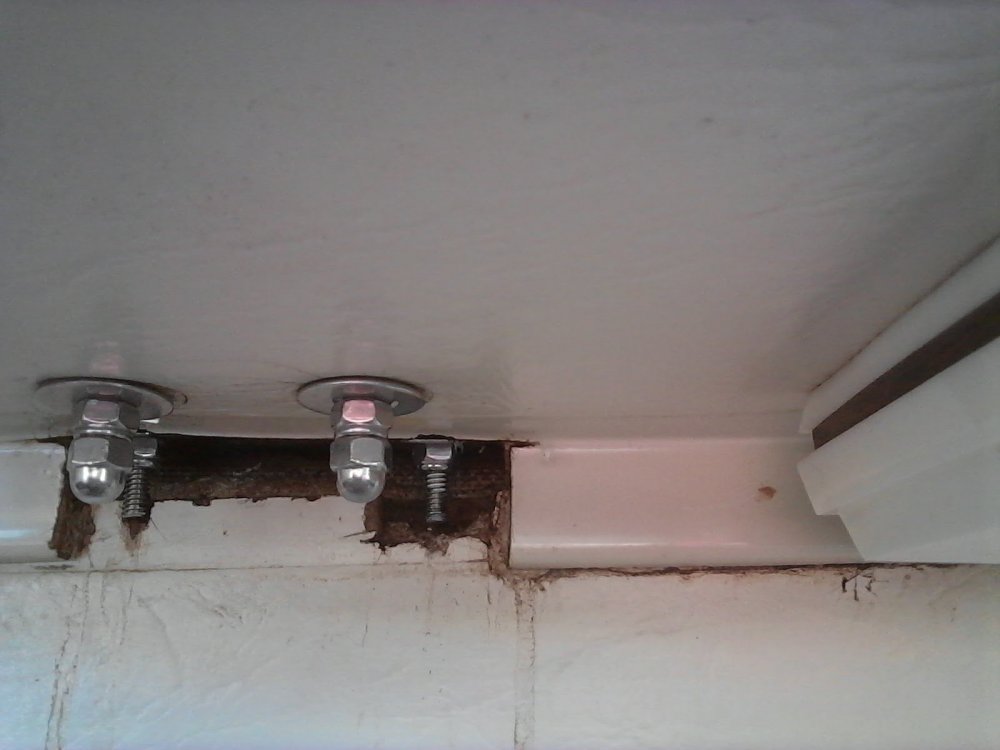

My '86 cat22 new design is leaking slightly from the through-bolts for the stanchions. Plan was to rebed with butyl after possible epoxy & redrilled bolt holes. After removing the pretty wood trim inside, I was surprised to see the 4 "through" bolts with the 2 inner bolts cleanly inside the hull/top overlap and the 2 outermost bolts seemingly dug into exposed deck coring just above the hull joint overlap. Pics to follow.
I need to seal those bolts, however,
1. the 2 outer bolts for each stanchion are nestled into the coring and near unreachable unless I dig out more coring

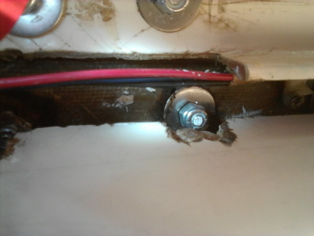

2. Whomever installed the stanchions used some type of sealant, epoxy maybe?, which has intentionally or accidentally encapsulated the bolts and washers. I'm not sure how to or if I even should break them free before using a wrench to loosen them.
3. If I use "peanut butter" epoxy to repair the exposed core/wood after rebedding/sealing the bolts, will I just invite future problems
4. Does anyone else's new design use this type of stanchion hack... um, installation technique? Is this a poor factory install or a not-quite handy man job?

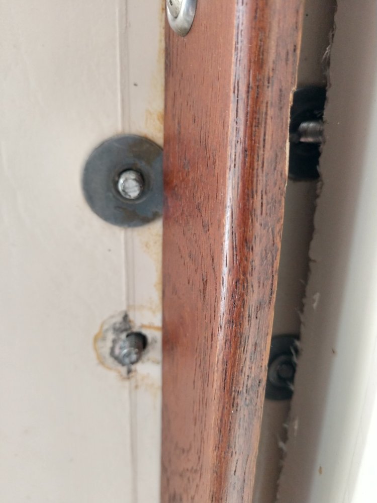

These are the 2 midship stanchions. I don't even know how to reach the outer bolts for the 2 forward stanchions. (See pic, only 2 bolts exposed, accessible)

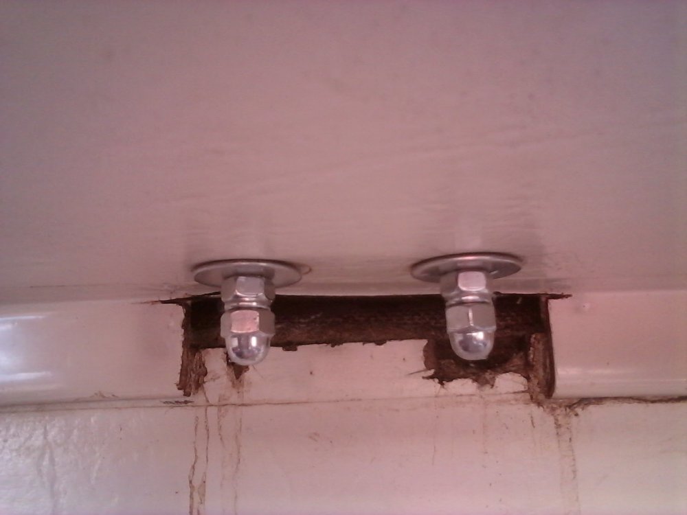

Port side midship, over the table
Starboard side, midship
Starboard with light, not sure you can see the epoxy? covering the nuts and washers here

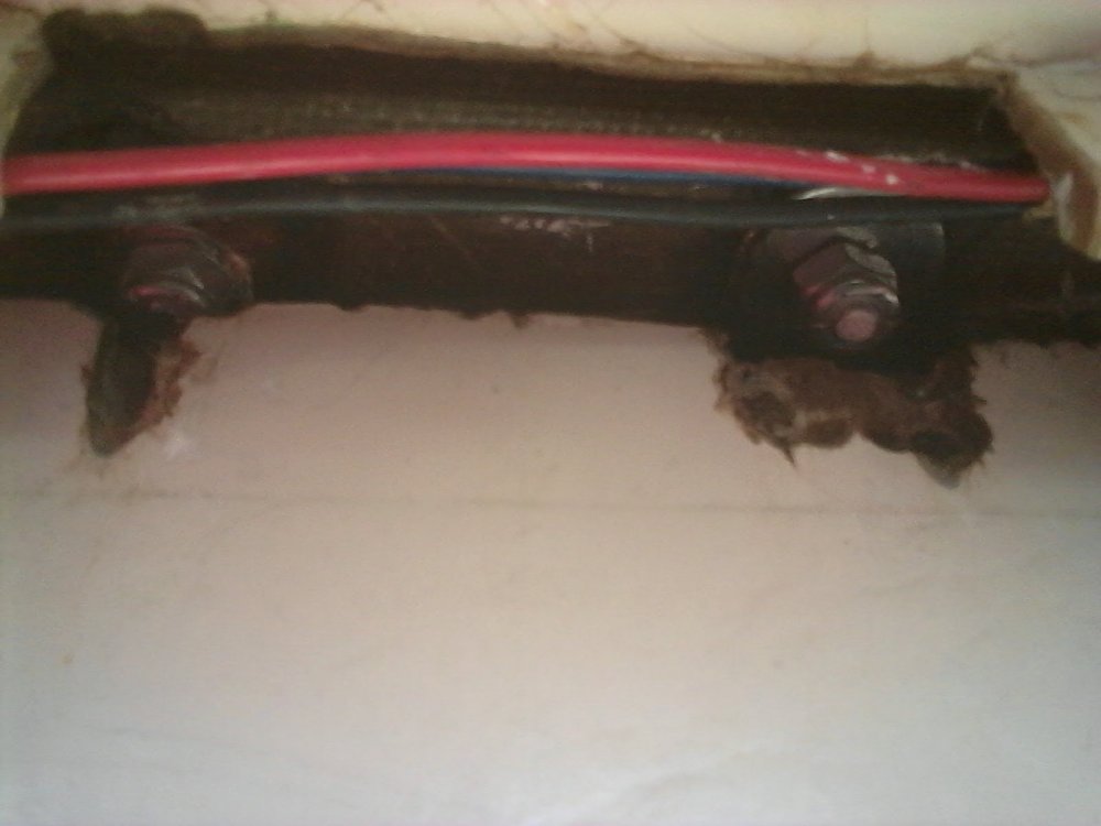

Port again, midship

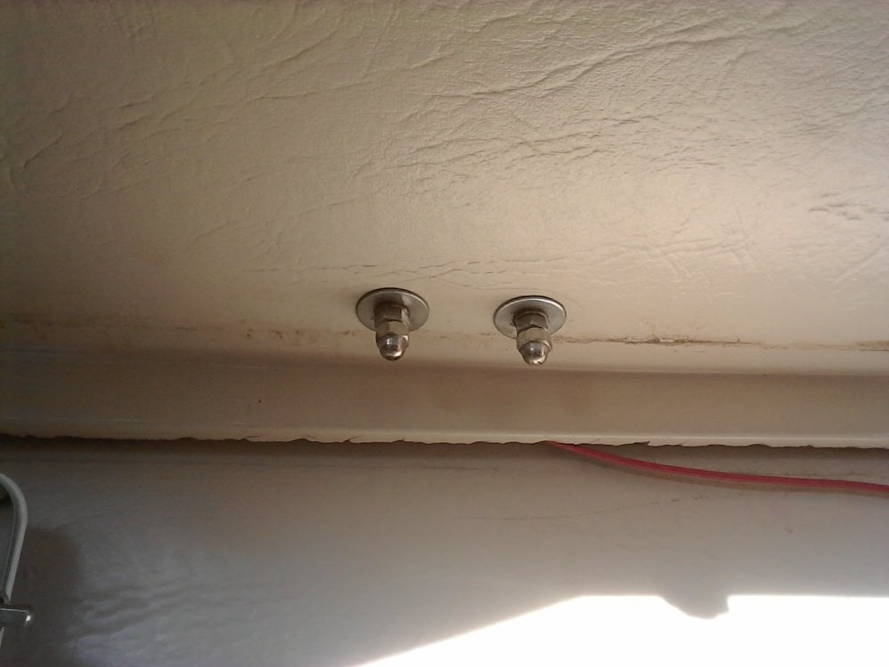

Starboard side, forward stanchion, only inner bolts showing

Can you back the bolts out from the top, by putting a vice clamp on the nut, and turning the head?
I'd probably try that if possible, and then place painter's tape covering the bolt hole, and fill the bolt hole from the top with denatured alcohol thinned epoxy. Good luck - it's always some kind of crazy access issue..

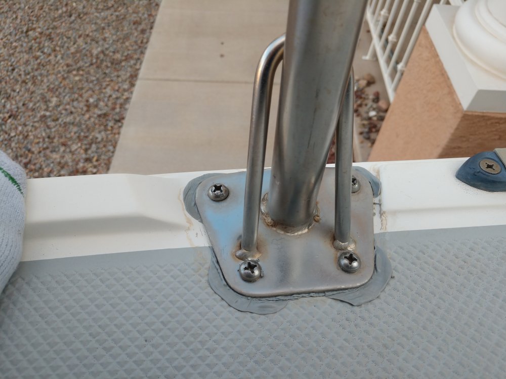

Mine looked just like yours. I had to cut away some of the liner with a Dremel to get a grip on the nuts.

My Wife and I just did our starboard side stanchions today -- a pair of needle nose vice grips was essential! Getting the washers and nut back on each was a fiddly time consuming process involving tape, super glue, and popsicle sticks.
