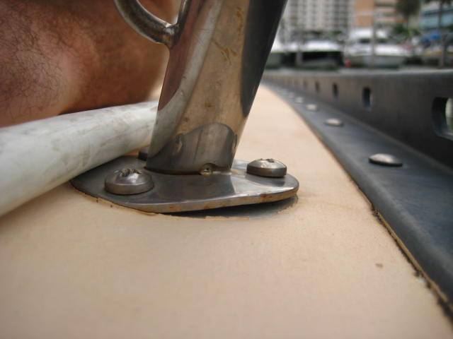

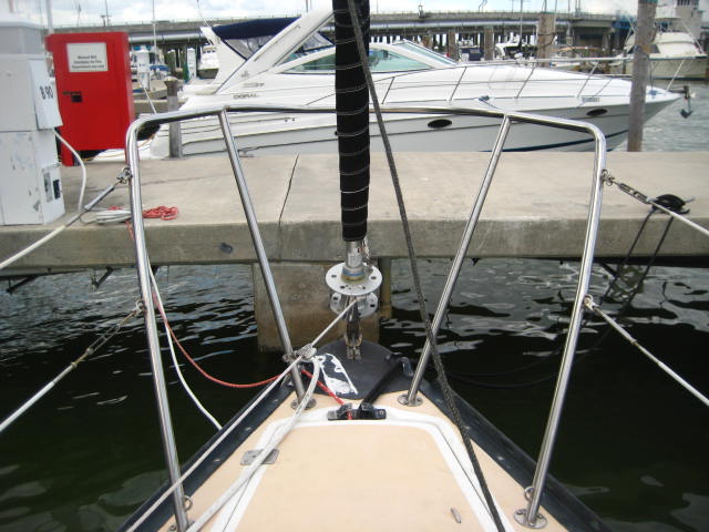

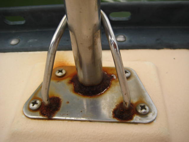

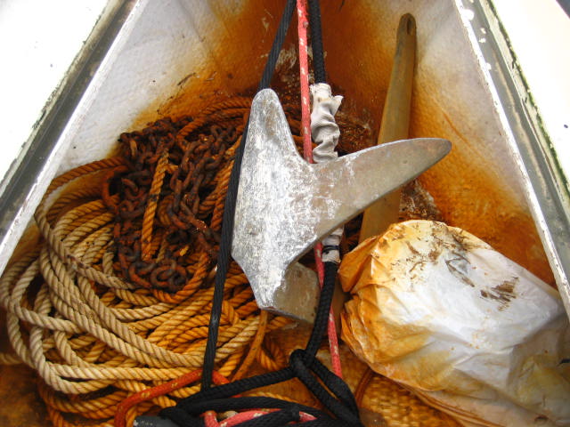

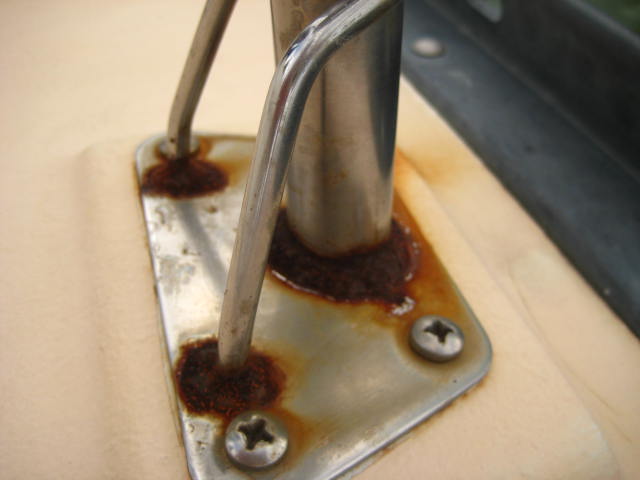

Okay, so I've got pictures below and new concerns up here. I went out, took pictures and determined that it is most likely NOT my stanchion bases which are putting water into the v-berth. My anchor locker was so polluted with rusted rode bits and paint chips from inside the locker that it filled up with water and appears to have gotten high enough to have found a hole in the glass somewhere. Take a look at the pics and let me know if you've ever had a similar leak in the "v" of the v-berth ( coming from starboard ). This water runs along the edge of the berth aft to the hanging closet.
Picture 1: Starboard Life Line Stanchion (first one coming aft from the bow rail )
Picture 2: Port Side " " " " "
Picture 3: You can see the bow rail leaning to starboard...
Picture 4: This is why... Aft-most, Portside stanchion base of the bow rail is lifted off the deck
Picture 5: My sad anchor locker. It is now cleaned out with new chain on the rode. I will need to repaint it though

Do all the stanchions look like that? They appear to have been welded. And with the wrong rod they will actually rust like that. Those stanchion bases are identical to the ones on my H37C. Never looked for replacements but did have one welded. It did not rust like that. There is another surplus store to check: http://www.marinesurplusliquidators.com/ . Anybody know how to find the marine surplus in Nokomis? Just north side of Venice I have been there many times, bought lots of stuff. But can't find them here on www.
