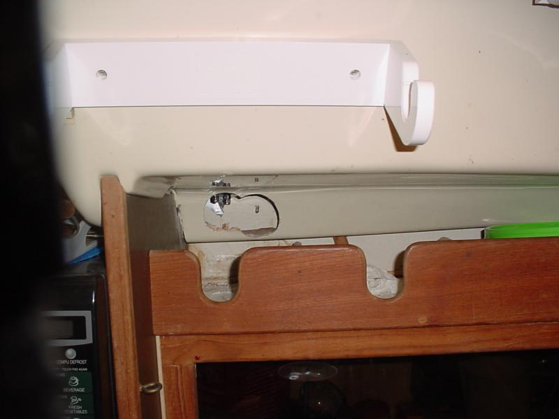

You'll need another pair of hands on the deck and a flexible head type ratchet wrench and you might be able to slip it under the fiberglass headliner but if you can't and want to get the job done faster then you'll need a hole saw

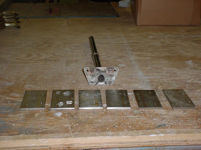

I had to make mine a little larger cause I made some backing plates to replace the weeny washers Oday put in.....I covered the sin with a blank electric outlet cover

If you have to cut access, do it. You can always make a cover that looks fine. IMO, there should be access to all stanchion nuts/bolts. At some point they will need attention.

Found the picture of the backing plates......these are 1/4 inch stainless but aluminum would work too
