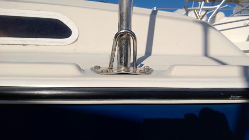

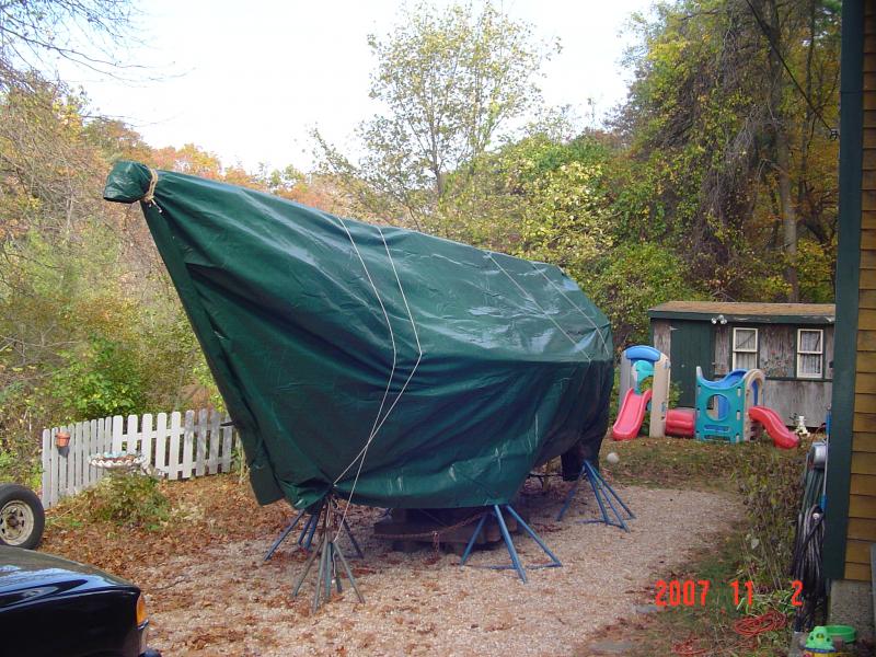

I have covered my ODay23 with a heavy tarp for many years using an A-Frame 2x4 structure, and with the tarp hanging down over the stanchions and lifelines. I now see that while the stanchions themselves are straight, there is a “lift” in the base plate (see photos) that looks like a drain. The stanchions are now leaning inboard. I never did see how to easily take out the stanchions for the winter.
Are these plate “bends” caused by the weight of the snow/ice pooling in the cover? If so, is there any way to straighten out these base plates without extensive boat “surgery”?? I do see some gruesome postings on losing the nuts inside if the bolt/screw heads are taken out.

It seems as if it should come off in order to straighten, and it looks like an easy fix...

Well, on the positive side of things, if you took the stanchions off to straighten the bases, you have a great opportunity to re-bed them and make sure they won't leak any time soon...

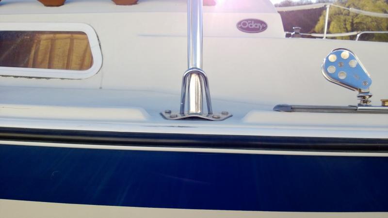

Yesterday I was working on the deck of my 25. Thinking of this thread I checked my stantion bases. I noticed that one of my stantions has the exact same bend. In fact 3 out of 4 are bent to some degree. Worse, the same 3 show signs of cracking at the weld. Luckily, access to the nuts in the cabin is very easy plus there are large backing plates.
