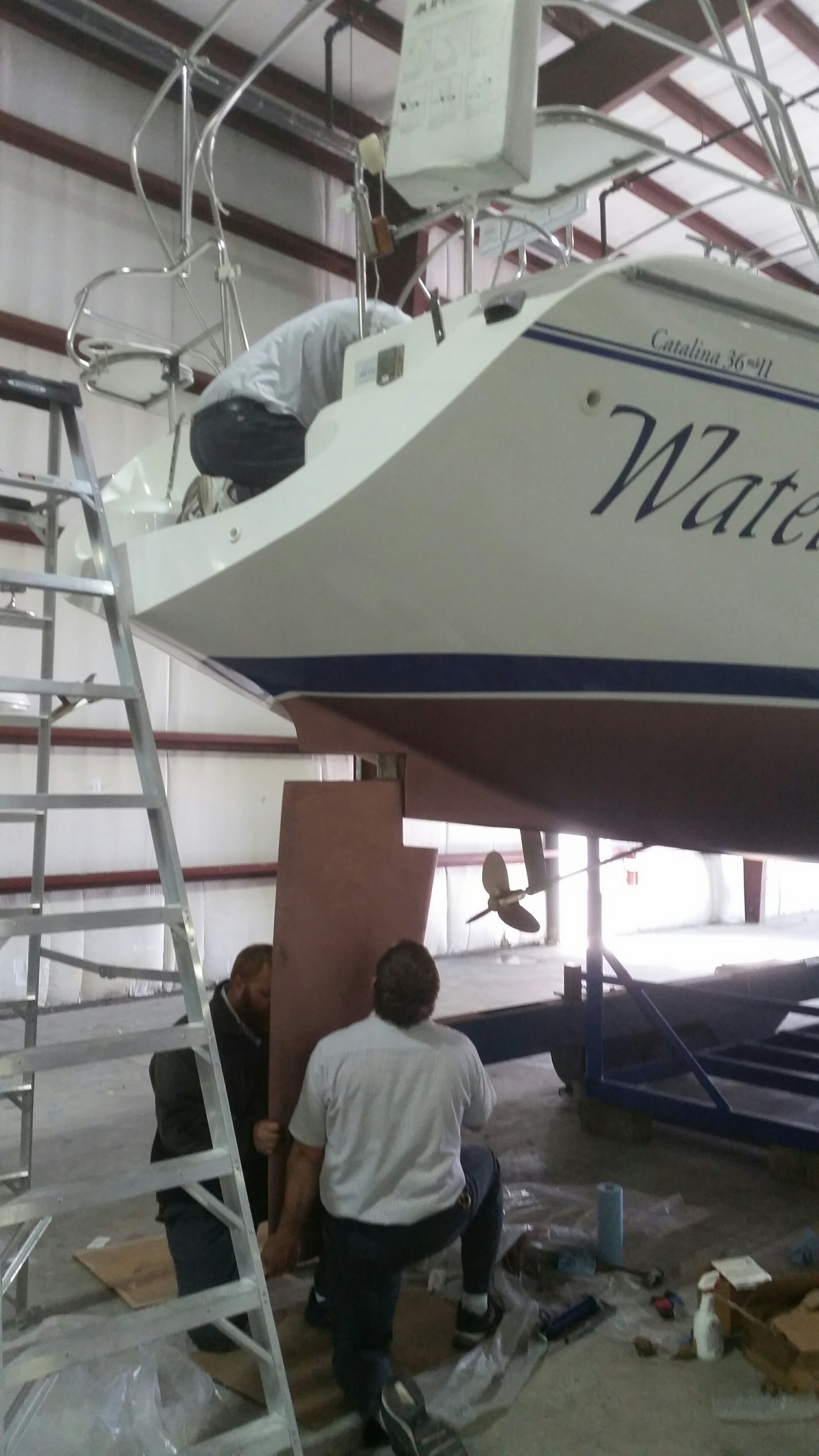

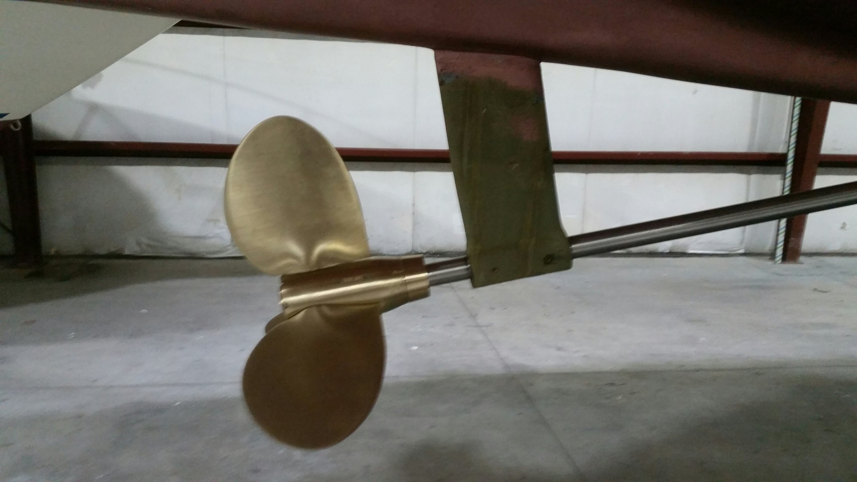

To wrap this thread up, I had our local yard install the 3-blade MaxProp with a new Aquamet shaft and cutlass bearing replacement right before the boat splashed this spring. They had to remove and replace the rudder as they could not get the shaft past it, although some C36 owners reported that it was possible after pulling the cutlass to allow lateral movement. The cost to have it professionally done was about $5,000, but I'm confident of the work quality. The boat yard was very understanding that I wanted to watch this done, so I stayed for the entire adventure.
The final product is a great improvement over the old 3-blade fixed Michigan Wheel. The boat has less prop walk in reverse, and stops on a dime. In fact, I had to adjust my docking as I used to put it in slow reverse approaching my slip and slow down as I coasted forward. With the new prop, I'd stop halfway into the slip as the boat would no longer coast. I've not seen appreciable slower motoring and reach hull speed around 2,100 rpm. The low wind sailing has improved, but there is no change for higher winds as I reach hull speed before the drag of the prop affects things. In summary, I think it was a good investment for my boat.

Nice job. You hit on the two best features of the MaxProp - great light wind performance and immense thrust in reverse. Shut it down in forward to feather, then move to neutral. Keep a shaft anode on it, the MaxProp anode is not enough.
