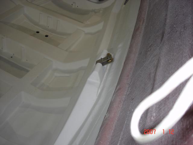

rgranger:
Attached is a picture of a 373 Beneteau under construction showing the chain plate attachment points prior to the installation of the deck and the thru deck connectors.
