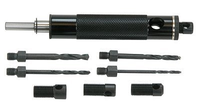

I have used the following to precisely drill out rivets without hogging out the holes. Could work well on seized screws if the right size can be selected.
Rockler Insty-Drive Self-Centering Bits

Thank you to all who commented here. You said pretty much what I thought I'd hear, though I like the reverse twist drill bit comment. I'll remember the Rockler Insty-Drive Self-Centering Bits.

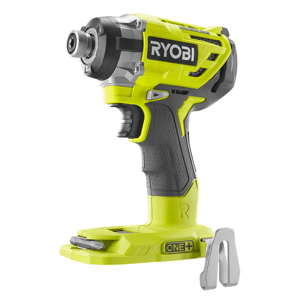

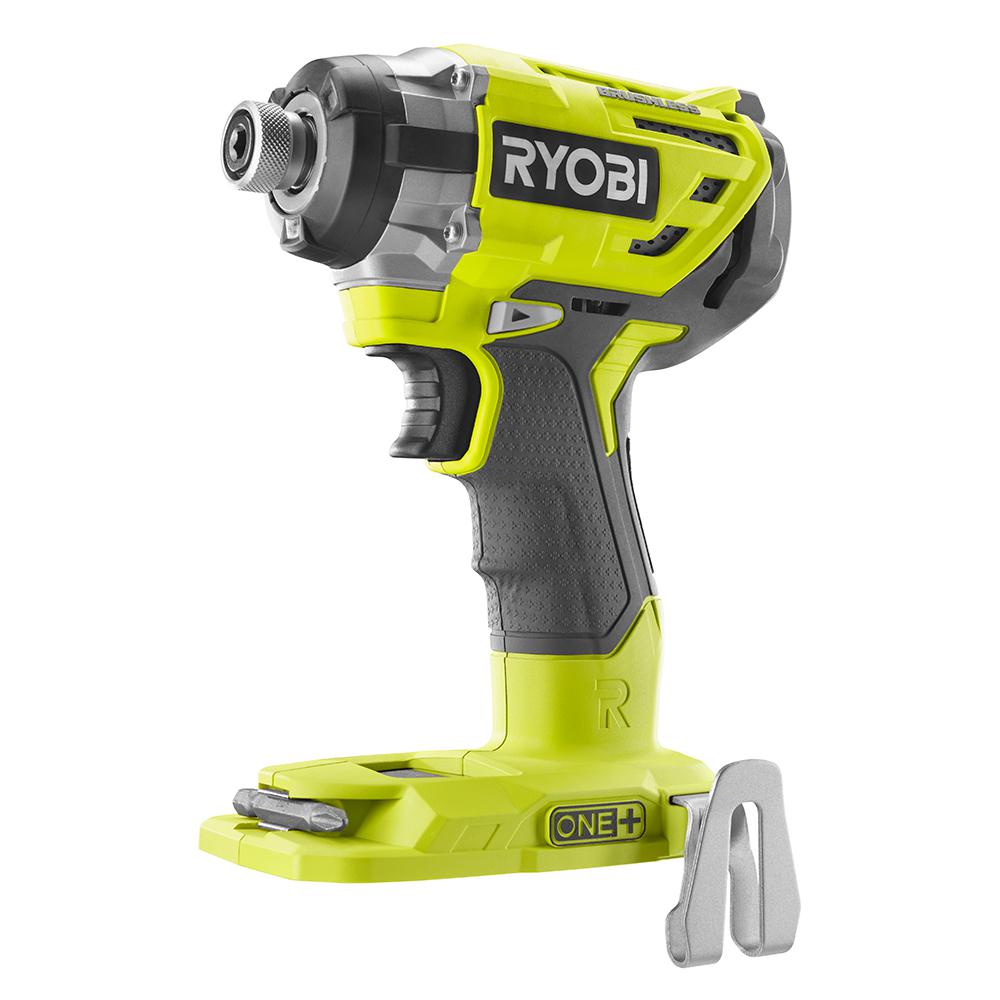

I will add- Rather than a hand impact tool, for fasteners the size you are working on, I have had decent luck with an 18V impact driver. I have a Ryobi but there are others as well. The key is to soak with PB Blaster for a couple days and be very careful not to let the slotted bit slip in the screw. The hand-held light weight combined with variable speed and torque that is not excessive is a real plus.

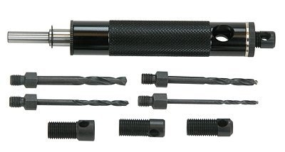

This is the actual tool I have used to rill out blind rivets of various sizes. Could be used to center a drill bit on a screw head. Aircraft tool supply catalogs tend to cause me to open my wallet
