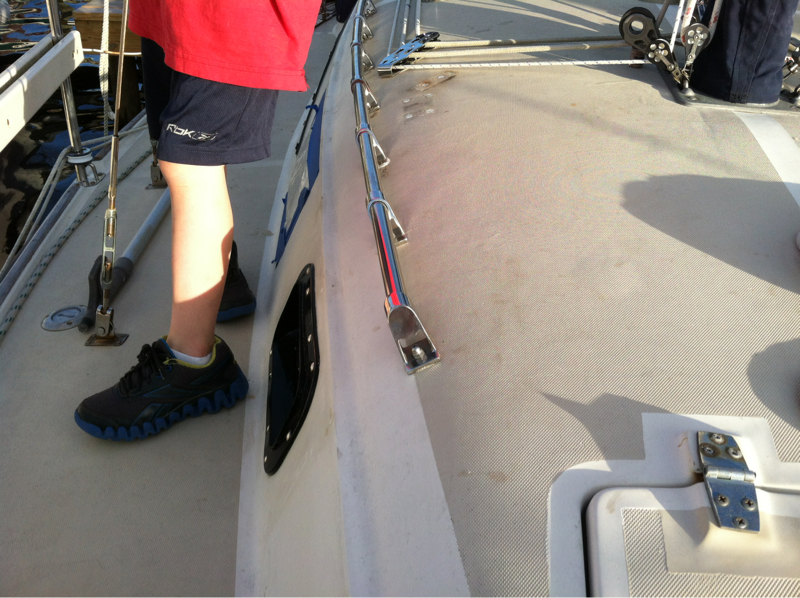

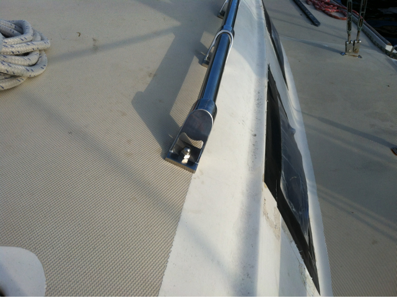

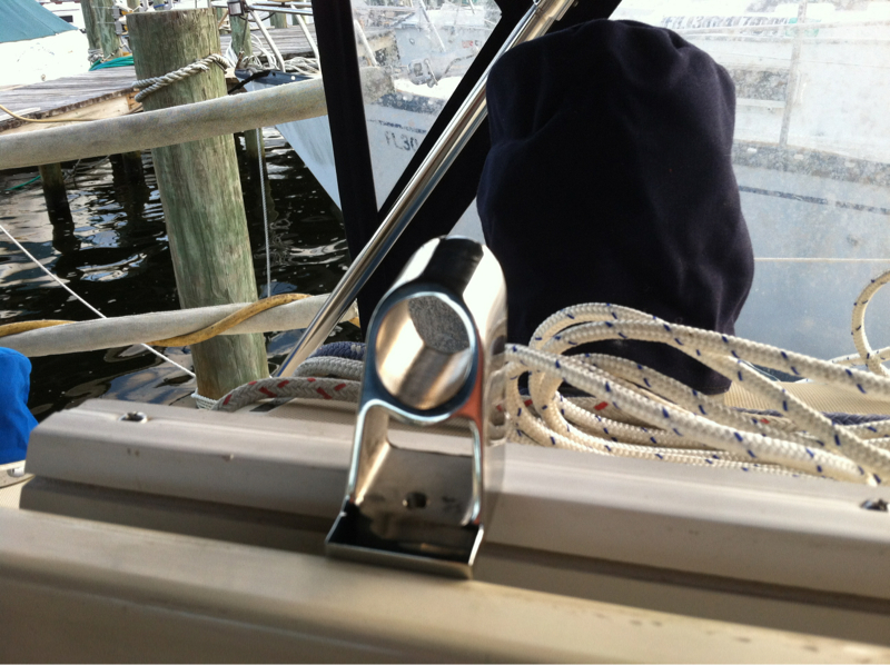

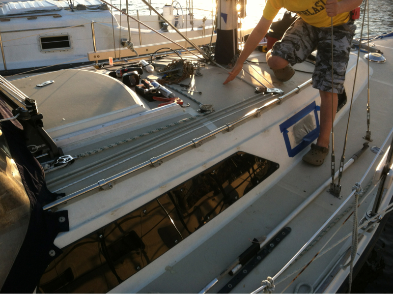

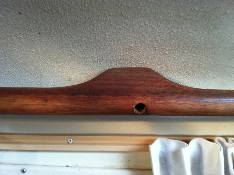

As much as I like the look of teak inside my boat, I'm not a huge fan of it on the outside. The previous owners obviously sanded the grab rails when they refinished them and as a result they were thin and weak. This weekend I finally got my stainless ones installed and the are great. I lucked into some brackets that had a single hole in the middle so they line up with the teak rail from the inside. One thing I did do was to countersink the opening on the deck and install an o-ring on the 1/4-20 bolt that came through. The I-ring was standing proud about half it's thickness so that when it's tightened it should press into the threads on the bolt and into the countersink. They are very solid on deck. I did extend them forward a tad over the stock rail. If anyone is interested I can take more detailed photos. I've also installed 24v 230w solar panel with great results. Next up is replacing the masthead sheaves if weather cooperates this weekend.
